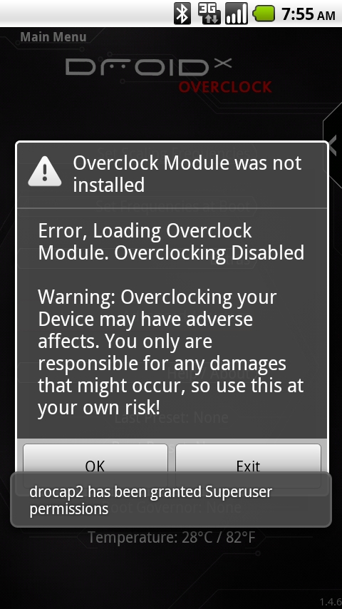

Anyone else getting an error since the update this morning? I've tried uninstalling and reinstalling and rebooting a few times and no joy.
I'm running ApeX 1.0 and everything was OC'd fine 1.2 LV before the update.
Screenshot is attached.
Got it on the initial startup after the update. Reloaded and its ok now.
