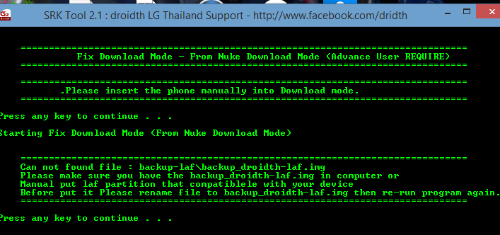

The file downloaded successfully, thanks. Looks like I'm not as smart as I think I am, tho. LitrosNub, will you please tell me EXACTLY which command to use? I'm at work right now, so there's no rush.
Well, the picture didn't upload. Will have to continue later on......
There it is!
There it is!
OHH I know what to do, Download Mode means fastboot - place it into fastboot and you need to find a LAF for your model and rename it. I'll try to find a LAF for 5.0.2.
Grab the LAF from here - http://downloads.codefi.re/autoprime/LG/LG_G2/D800/Stock_Firmware/30f_partitions
and rename it like in the picture and put it in the folder it wants to be in, then reboot to fastboot and follow the instructions.

check the picture backup-laf, if it's not there create a folder called 'backup-laf' and put it there, then use Fixed Download mode
if this doesn't work I'll hand the work over to @iowabowtech see if he can fix it
also - what? partitions? you just need the LAF.img from there and rename it to what it says in the picture then put it in backup-laf in the srktool folder.

The program wants me to manually go to Download mode, and I can't. Thank you SO much for spending so much time on this, LitrosNub!
Fix Download Mode - From Nuke Download Mode (Advance User REQUIRE)
.Please insert the phone manually into Download mode.
Press any key to continue . . .
Starting Fix Download Mode (From Nuke Download Mode)
found file : backup-laf\backup_droidth-laf.img
Device detected in FastBoot mode
error: cannot load 'backup-laf\backup_droidth-laf.img'
rebooting...

Yes you would launch all commands from the platform-tools directory and it sounds like you're doing that. Your results are a bad sign I'm afraid. It's a semi-new, yet increasingly common phenomenon I call the Lollipop fastboot brick. Basically speaking, it means you can write fastboot commands and the phone recognizes that you did that, but it won't process them.
That is bad and it's almost certain that the tool won't work for you either while in this state. There is a way out of this but it's not fun. You're looking at this:
http://forum.xda-developers.com/lg-g2/general/lg-g2-unbrickable-fix-real-hard-brick-t2904404
What you do there is short some specific capacitors on the motherboard to invoke qhsusb_bulk (9006) mode if you are lucky. Or QDLoader (9008) mode if you're not quite as lucky...though both can be fixed. 9006 can be fixed using either Linux or once again, the same tool LitrosNub posted earlier. You'll note it has a bulk mode fix option in it. If you end up in 9008 mode, you'll have to post back and I can walk you through that.
rebooting...
Damn, I'm all out of ideas, I'll hand the help over to @iowabowtech, I hope he can resolve it.
Iowa's right, I've seen this problem before on XDA - the G2 processes the commands but it doesn't do em'. You'll need to short out the motherboard or else your looking at a non-recoverable device. Even with that the risks could still be high.
