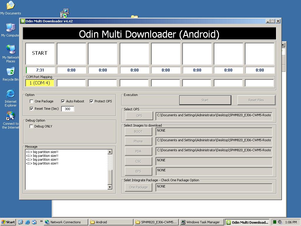

I found some WinXP love. ODIN is cranking but it's taking forever. I didn't specify a BOOT image and to became stuck on downloading BOOT for 10 minuets. Restarted it with local copy files and now it's hanging after the last "big partition size" warnings.

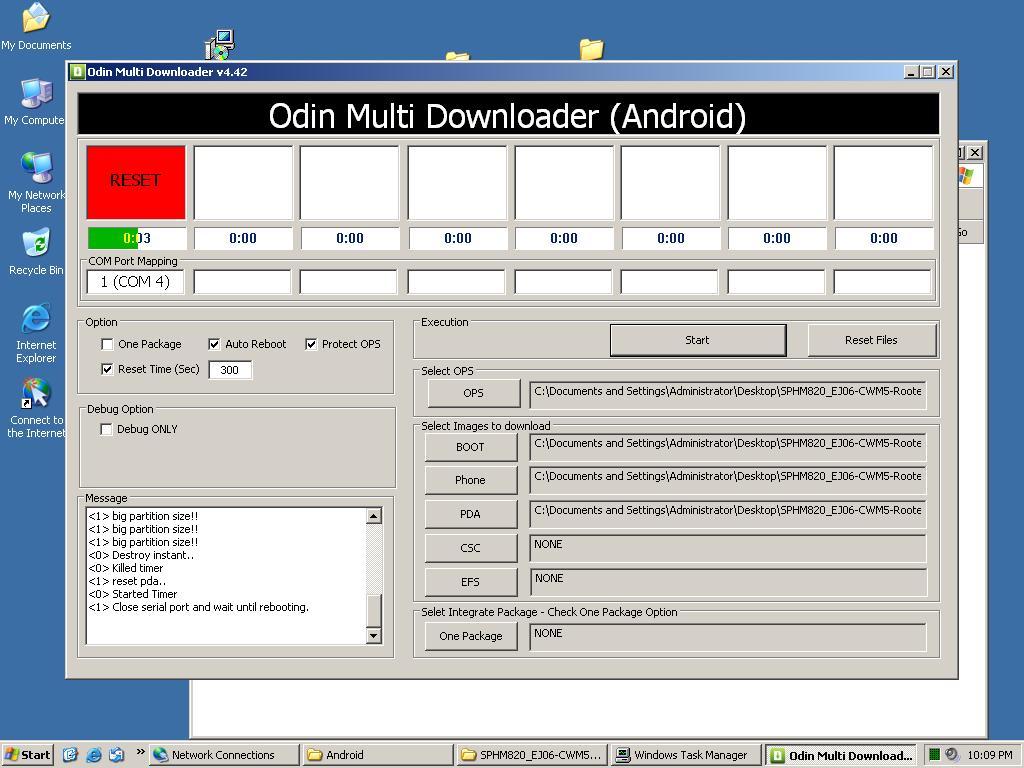

Flashing boot gives an immediate error "Destroy Instant". This occurs even with the battery and SD card removed.

EDIT: Moving Odin and the image files From the desktop to the c: drive helped (AMSS dl running). So, for Odin to work, don't
a) Run it from a network drive
b) Run it using any directory with a space, alias, or skyline in the path
More updates as I get them...
EDIT2: AMSS bombed. It has been running for over 270 minuets. Now we're back to square one. I have no idea why my phone refuses to flash. Perhaps I should take this to an ODIN thread?
