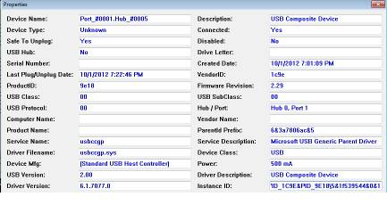

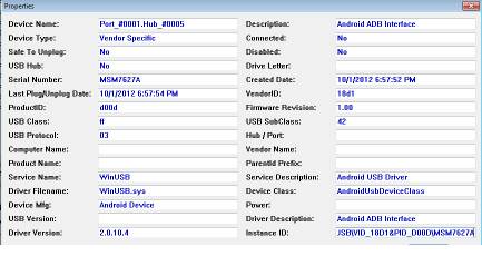

No way man. In normal mode when phone is connected,my device manager shows "ANDROID COMPOSITE ADB INTERFACE"and fastboot mode by v- ... p it shows "android ADB device". Latest version pof unlock root fails to instlall driver-only this option it shows when i try to root with it in normal mode.is it poss to click unlock root in fastboot mode,as android adb interface only detected in that mode.

Why shoud i go for stock rom,when i have that already with me. Better you suggest any other tool like unlock root for me.this time driver is loaded by clicking unlock root.but option for driver comes even after succeful its own driver installation.
I am also surprised.see the two different id ,one in fastboot m and another in normal mode.
ok i got ur problem ,this is the issue with adb one
