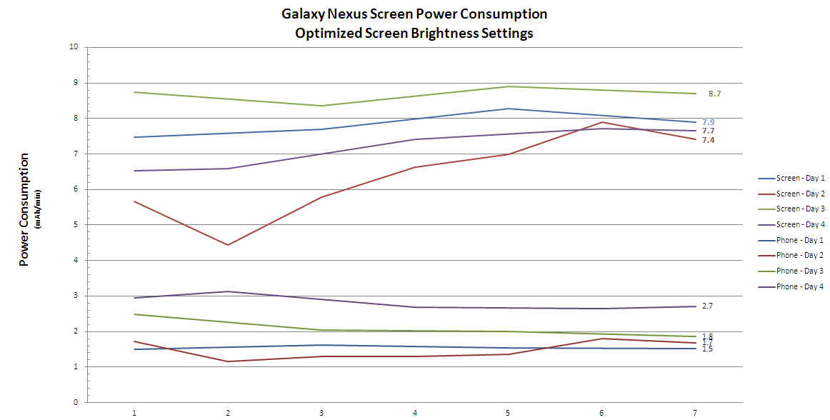

For the past two weeks I have been conducting a pretty elementary study of the power consumption of the display on our GNexs. I will come back in this first post and lay out how I came up with these numbers and give some details on this experiment.
For those wanting numbers and graphs, skip to the second post.
For those wanting conclusions and tips, skip to the third post.
Conditions: I am running a Galaxy Nexus CDMA/LTE version with an extended 2100 mAh battery. I use my phone indoors the majority of the time, but do use it outdoors some, and did during this experiment. My phone is rooted, unlocked, and running AOKP Build 28. This was key in running this experiment as I will explain below in part two of the experiment.
For the first part of this experiment I set my screen brightness settings to manual at 100%. I used the battery stats collected by the system to calculate the screen usage isolated from all other battery usage of the phone and vice versa. I kept track of the phone isolated from the screen to make sure the readings were consistent and there was no duplicate battery stats in common with each other that would have affected the study. In the end, the phone consumption stats independent of the screen were very consistent, almost surprisingly so. You would expect the battery usage to vary a little due to difference in usage from day to day, and it did, but it wasn't very much. Numbers and graphs will illustrate that.
For the second part of the experiment, I utilized the ability to edit screen brightness levels, reset levels, light sensor filtering, etc contained in the build of AOKP I was running. I tweaked the brightness levels that corresponded with ambient indoor lighting levels to the absolute minimum and made the levels that corresponded with full sun outdoor lighting levels be max brightness. For the levels in between, I tweaked these to my satisfaction and am still tweaking them today. I wanted them to be at the absolute minimum that I could still easily read my phone. This took some time and effort, but worth it to me. Other than that, I repeated gathering readings like the first part.
If you want to know exactly how I took these readings, I'll be glad to discuss that later or come back and add it to this post with sample calculations and what not if necessary.

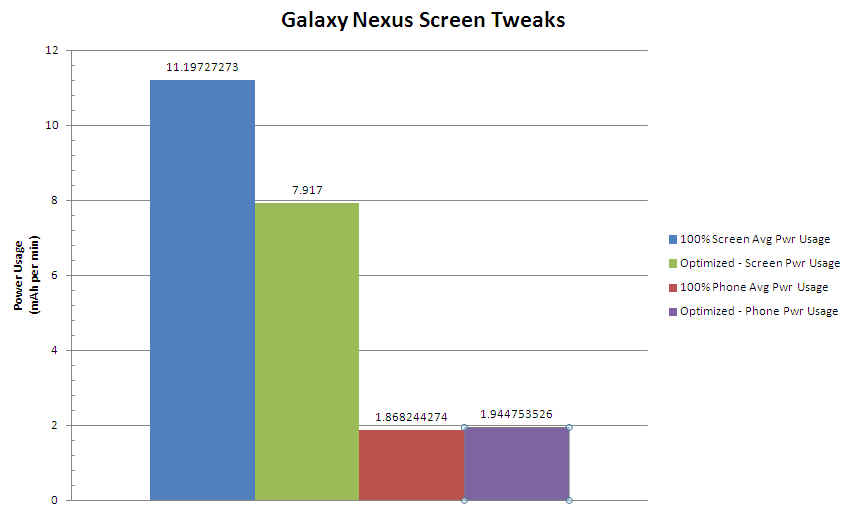

On to the results...(see post 2)

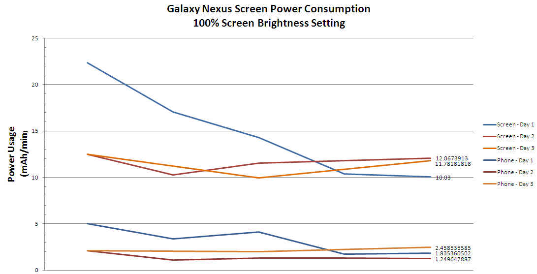

Screen at 100% Brightness
Battery consumed by screen: 11.20 mAh per minute
Battery consumed by phone: 1.87 mAh per minute
Optimized Auto Brightness
Battery consumed by screen: 7.92 mAh per minute
Battery consumed by phone: 1.95 mAh per minute
As you can see, there was very little difference in the battery consumed by the phone, meaning the screen battery usage is isolated from the phone by the android system by using the percentage used stats.
More importantly, you can see that there was a significant difference in the power used on a per minute basis between the optimized auto brightness and 100% power at all times. Keep in mind, this was an average of numbers throughout the day and that difference could have been even greater had I been able to use only indoor lighting levels at minimum screen brightness. Granted that was indoors 90% of the time, but it could have made a noticeable difference.
The average battery savings seen over this study was 29.29% from 100% brightness to the optimized auto brightness levels.
A second thing I noticed, which you'll see especially on the 100% brightness level graph, is that white backgrounds greatly affect screen power consumption and it is even more exaggerated when running 100% brightness. Black seemed to draw the least power, which souldn't come as a surprise to any of us.
