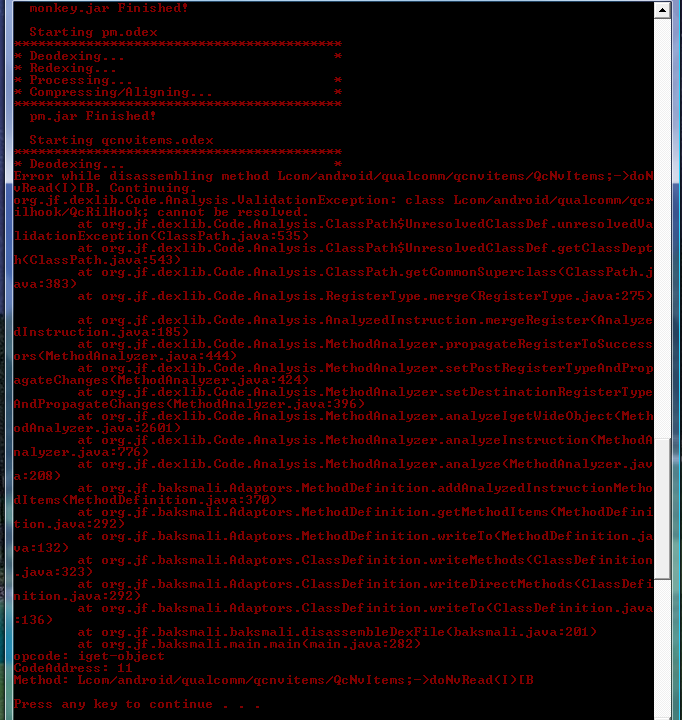

I get this error when trying your method it happens in the framework part of deodexing. If it matters running windows vista business. Am I doing something wrong?
Hey well I looked at another tut for doing this and it said if you had and error to remove the .odex file from the orig_* folder so I did. All that does is make it skip it when deodexing which doesnt produce an output file.So anyways I did that and it was smooth sailing through the process...tried the zip align in your post and it didnt work for me. But i think that it zip aligns it when it deodexs anyways coz it says deodexing/aligning when its working. But anyways followed the rest of the guide and got a successful boot. So Id say so far so good. Thanks for the guide!
