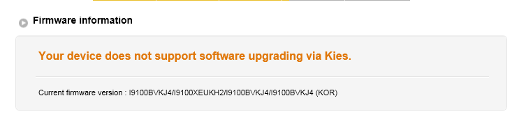

I'm currently on Orange UK and after trying to update my phone via kies from the current installed GB 2.3.5 I9100 BVKJ4 rom I have to any possible updates.
I know GB 2.3.6 exists but kies refuses to update when I connect my phone, so there's no chance of an ICS 4.0.3 update either!
Now from doing some research it seems updates are only applicable if you have the correct firmware country setting from the multi CSC file loaded onto your phone, which kies recognizes.
On checking my firmware country settings the CSC file by typing *#272*Device IMEI# I can only see - 'KOR' which tells me this is 'Korea' where Samsung are located.
It seems to be a SINGLE setting only!
I know if I install a MULTI CSC file via odin into the phone I can change the setting from 'KOR' to 'XEU' for example or any other country option available.
I believe the 'XEU' firmware setting in the csc is meant for the UK and that the 'XEU' setting is the latest one out ?
So maybe If I change to the latest firmware 'XEU' file, kies might recognise an update for my phone?
So where can I download the multi csc file that will work with my current Orange BVJK4 rom?

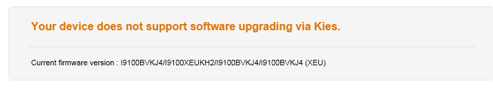

However upon connecting the phone to the latest version of kies.
Kies recognises it STILL AS 'KOR' doh :confused:
*#272*Device IMEI# and the phone says 'XEU'
Doesn't make sense ??
:mad:
Any ideas ??

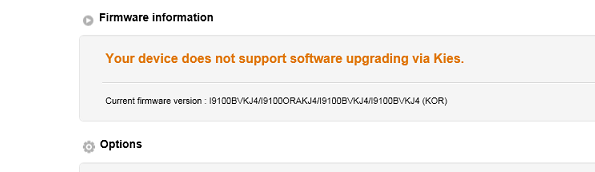

Right to change 'KOR' to 'XEU' the multi CSC file has to be from the same version of the operating system installed on the phone.
I used the multi csc from the last known latest version of GB 2.3.5
Because that's what's installed on my phone Gingerbread v 2.3.5
XWKJ3
Firmware info
PDA:XWKJ3
PHONE: XXKI4
Date: 25/10/2011
Android 2.3.5
XEN (Netherlands)
Now kies recognises the phone as being 'XEU'
But still no updates - not even to GB 2.3.6 !!

You won't get any updates via Kies now because your handset is Orange-branded (ORA CSC) and therefore the deviceID won't match the altered CSC (XEU).
Incidently, the latest Orange firmware version is 2.3.5 (BVKJ4). That's why you weren't notified of an update previously - there isn't one.
