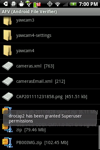

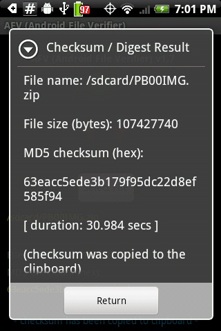

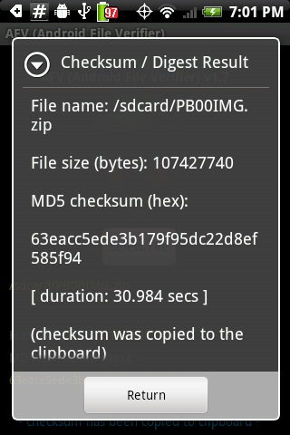

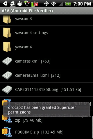

You're fine...you probably really don't have the PB00IMG.zip file in the /sdcard folder or its not named exactly "PB00IMG.zip".
Just do a battery pull and reboot back into Android. Then, let's double-check that your file is in the proper place.
I'll post a screenshot of how my version looks in AFV so you can compare...brb.
Okay, first screen shows AFV navigated to the top of the /sdcard:
Second screen shows where I scrolled-down to the bottom of the file selection list and the PB00IMG.zip file is the last file on the screen:
I re-did the MD5 checksum and you can see how AFV reports the full filename as "/sdcard/PB00IMG.zip":
Let me know if this matches what you see.
Cheers!
Cheers!
That's what mine says. The duration is longer on mine but everything else is the same.

Ok, here is where you can download the latest radio file for flashing: July 2010 Eris Radio - 2.42.01.04.27 - xda-developers
(You should be downloading 2.42.01.04.27.zip)
Note that the MD5 of the file is: C96AD832CFA22F1F1CF56F1A45B8A5EF
Please, please, please: after copying this file to your SD card, check the MD5 hash of the file on the SD card to that file. It should match exactly. You can use Scary Alien's application AFV on your Eris to do this; the app is here in the market: https://market.android.com/details?id=sa.afv&feature=search_result#?t=W251bGwsMSwxLDEsInNhLmFmdiJd and Scary has instructions for use here: https://sites.google.com/site/scaryalienware/afv
- From main / home screen, press the "Select File" button to enter the file-selector
- Top row (folder icon with the green up arrow) always displays the currently selected directory (touch this row to navigate UP one directory level)
- Back key can also be used to navigate UP one directory level (will return to main screen when pressing back key at root directory)
- Navigate to other subdirectories by touching a directory row (folder icon)
- Touch screen and drag up and down to scroll through all files and directories in currently selected directory
- Long-press on a file to view the available functions:
- Calc MD5 Checksum
You'll also have to re-root the phone; using the 1-click root app on the market is probably the easiest way: https://market.android.com/details?...1bGwsMSwxLDEsIm5ldC5hbmRpcmMuZXJpc3Jvb3RlciJd
