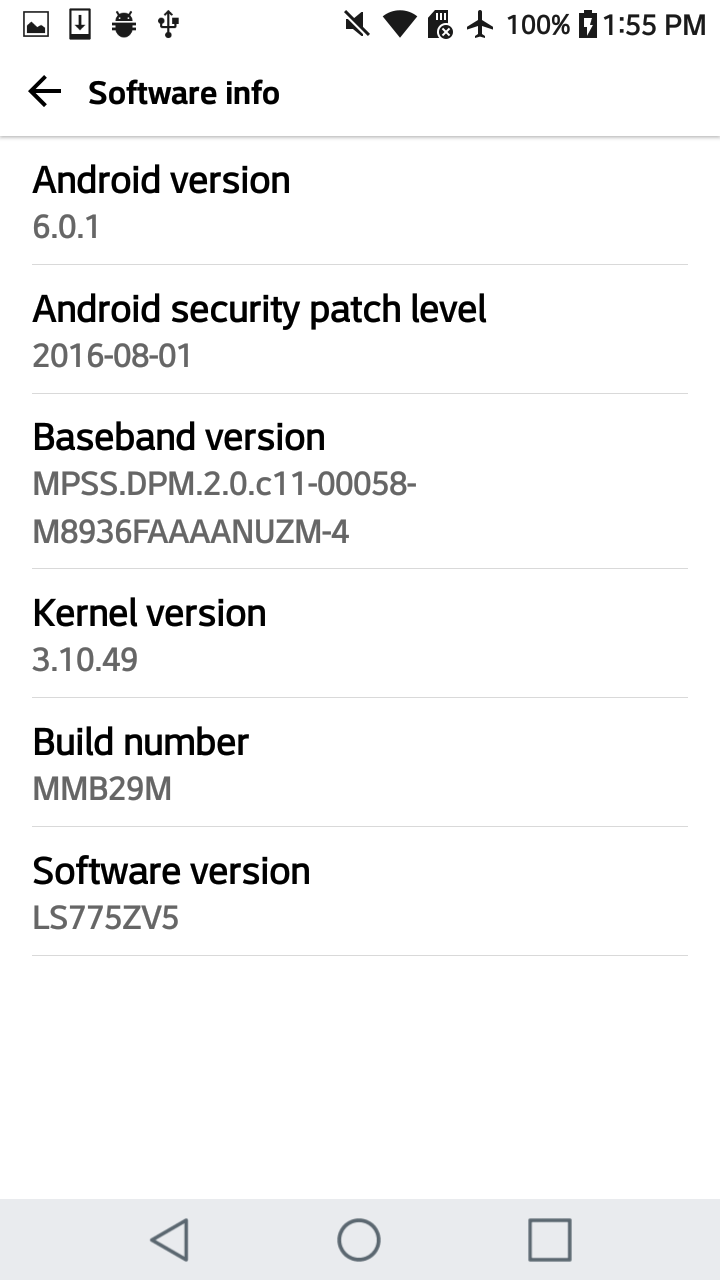

I just arrived late to the party. I am coming from the early development of the LG Tribute HD which is still unrootable at this point..I banged my head against the wall over that phone. Anyway I saw boost had twrp working on their stylo 2's so I picked one up from Virgin and its on V5. It's :/ I've been offered help and I'll gladly take it but as far as root is V3 the only version that can be exploited? I am downloading the V3,V5 and nougat asop sources right now and I have the source code so would building be worth it? PM me here or on XDA I don't have hangouts or whatsapp, really hoping on this one :)
If u can get the kdz zv3 thats on this forum and get it flashed then can get root its the only one with fast boot zv4 and up lg disabled it grrr i think its worth it
