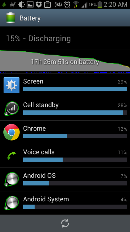

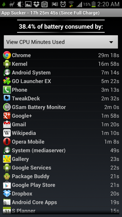

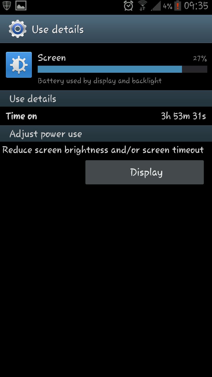

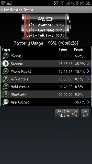

I just wanted to know if I had a healthy battery... Sometimes I feel like it's draining too quick, but then again, I never had a smartphone before so I've no idea what to expect.
I keep reading all the battery related threads and some people I see Screen on top with a hella' battery left on 1d +... And I get jealous :/ lol...
So here are screen shots... How's my battery and how is yours?

Looks decent. As long I can pull the phone off the charger when I wake up, and not have to worry about a charger until I lay down, then I'm content. Longest I've been was like 1 day 16 hours with like 20% left.
What is the brightness of your screen set to? If its been on for almost 4 hours and it isnt taking the top spot above standby Id have to assume almost all the way down.
Looks fine. It can be hard for screen to overtake cell standby when cell is being calculated incorrectly by 10 times (multiplied)
Automatic... it's always in the middle though, sometimes very bright for a minute or 2.

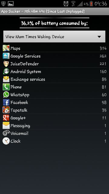

Also, I put up the apps and number of times awake... And maps app is on top. I have gps enabled, but maps is disabled. What could be the reason the app keeps waking my phone?
Also, is it normal for Android System to have 4000 wake locks?
Are you signed into Latitude, that can be a big drain on your battery, especially if you have GPS enabled

Latitude is part of maps, you can use it to see where your friends/contacts are.
Open Maps and click on the layers tab ( bottom right ). if Latitude is ticked then its enabled. Just untick if you don't use it
Google has absolutely FAILED on its ability to control the Maps app they created IMO...i can disable all of the apps auto start instances and it still will wake up my phone...
part of the problem (i believe) is that all "location services" wake locks get bundled into the "Maps" category...either way...if i don't activate Maps at all during a day, as far as im concerned...it should do NOTHING...total failure on Google's part IMO...

Yes mine too, but only if you use the screen a lot. In international gsm there is a miscalculation in battery stats whereby its calculated at 10x its actual value

Here's what I ran yesterday. I would say moderately used (lots of texting, some web, some games and other messing around). I keep my screen brightness at about 50%, and run a live wallpaper, and this was a bit over 3 hours screen time. I do wonder why my Google Maps is taking 5% of the battery when I didn't use it once yesterday... I noticed it running in the background at one point and killed it. Anyone know why Maps would run for no particular reason?
Do you have gps enabled? Maybe there is an app running that's using the maps app...
Usually after I use maps I quit it so it doesn't run in the back... Because sometimes I feel like it does. My gps is always enabled, but maps never really takes any of my battery.

Yeah I never turn off my GPS, but the thing is, I never even opened Maps yesterday to begin with, so that's why it really caught me off guard that it was running and draining battery. Unless like you said that some app I'm using is enabling Maps but I can't imagine which one it is.
My gps is always on. Other than maps, Facebook calls gps. So does the mobile version of the Google site
I knew certain apps called GPS (Facebook, Google, etc.) but didn't realize that actually called up Maps as a process in doing so, although I guess that would make sense! I was thinking maybe it was my weather widget and/or live wallpaper but I guess it's just the gps initialization when I open certain apps...
