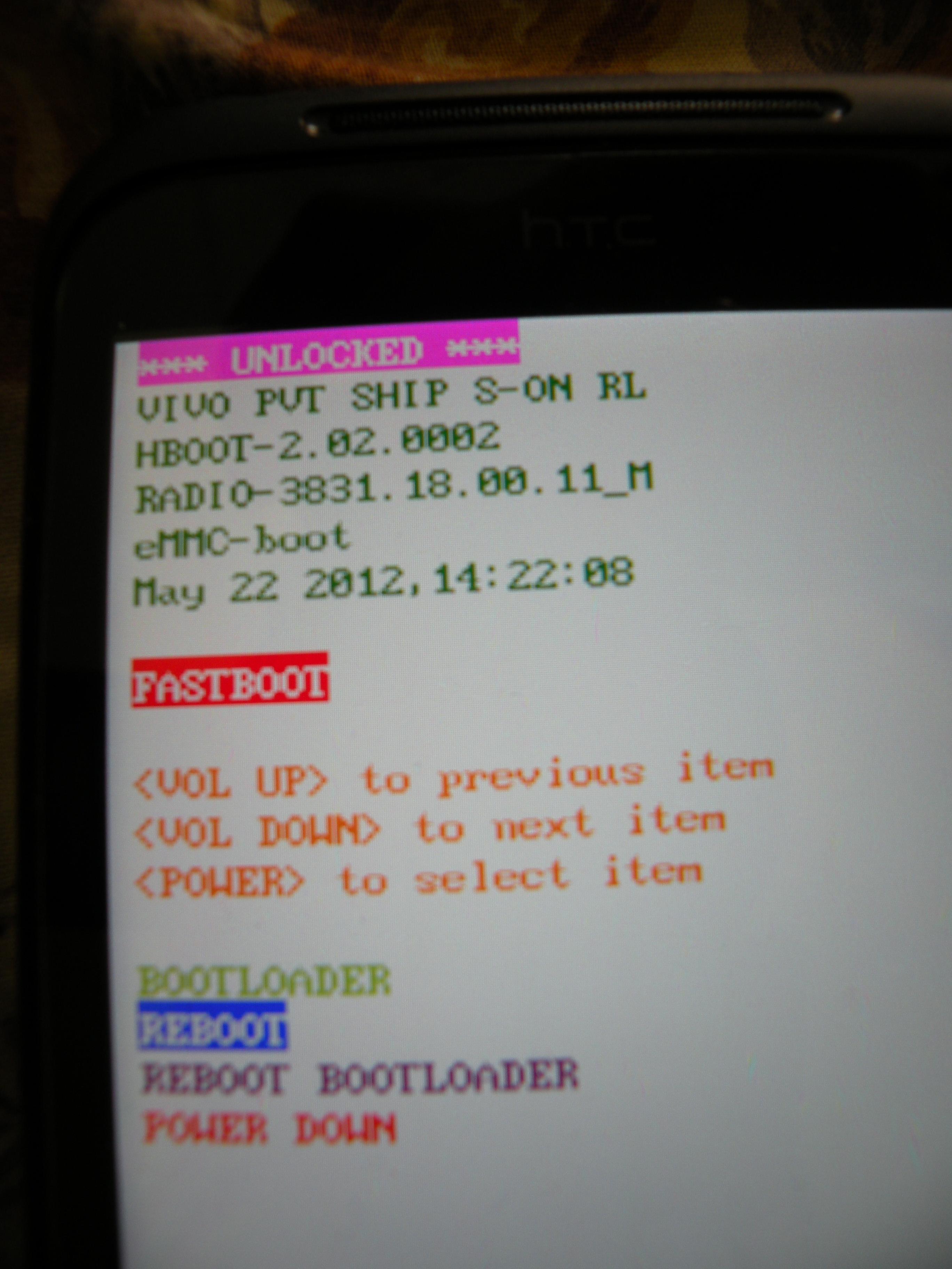

Hi Folks,
I have trying to return to stock ROM when my Incredible S is already bootloader unlocked, rooted but S-ON and running custom ROM CM7, Android 2.3.7.
I tried to follow above steps to return to HTC stock ROM which can allow me to go to ICS with OTA updates.
But in the very first step, my HBOOT does not detect any PB31IMG.ZIP or PB32IMG.ZIP file. See the attached image.
My SD card file type is FAT32.
What could be the issue here ? What next I can do ?

these instructions are for the original htc incredible, not the incredible s :)
this is the most recent guide i could find for your phone:
http://forum.xda-developers.com/showthread.php?t=1359555
but you may want to look around here:
http://forum.xda-developers.com/showthread.php?t=1136463
