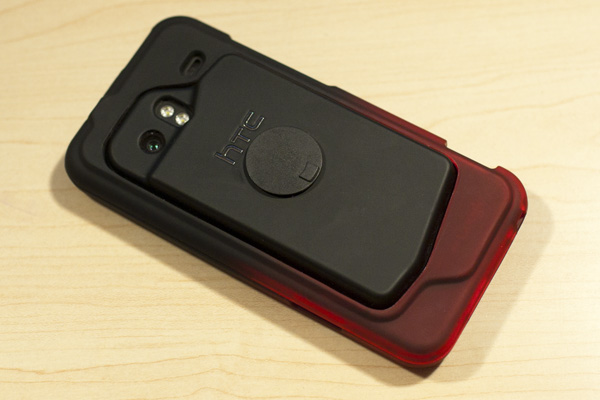

Yea I dunno. I kinda like the black/red gradient one a little better since it's more subtle. I am going to edit in pics up top of my finished work.

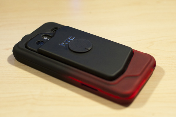

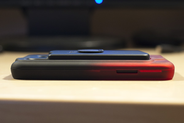

The keys to dremeling a case for me were:
1) Take your time and don't worry about perfection from the start...Straight lines don't have to be perfectly straight & curves don't have to be perfectly circular. I also used small circle attachments I had in my dremel case but you can do it carefully with just the straight blade going around at small angles.
2) Cut out all the basics and keep seeing if the case will fit the extended back, just keep taking off little bits and pieces until it will start to make it over.
3) SANDING! This is the most important part. I think I used a 300 grit sandpaper to start and I just ripped off little pieces and went pretty hard around all the edges of the case for about 15-20 minutes. This is what will make uneven lines even, it will also help shapen curves (by rubbing them out with a little piece of sandpaper rapped around in your finger) Also don't be affraid to use your fingernail around the edge of the case to get rid of any little (don't know what they are called) "shavings" that are still slightly stuck on. They will come off with some force and won't remove the paint on the rest of the case when doing so.

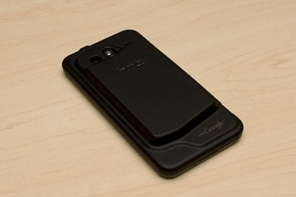

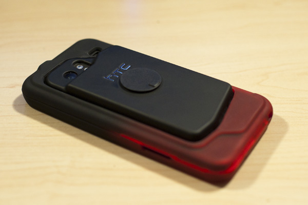

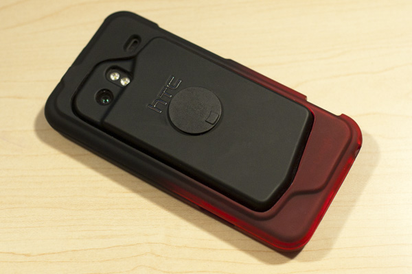

I got my HTC 2150mAH battery today from VZW. It's HUGE, but I've been thinking about how to make it more streamlined since I heard about it. Enter my dremel work.
Dremel out the rear of the VZW snap case to match the bulge on the new battery door. Sand it down smooth, and here you have it. It's pretty nice feeling, and it doesn't bulge out too much. It's still bulkier than before, however if you had a protective case already it isn't much of a difference.
Now, my phone looks good and holds a charge longer.
