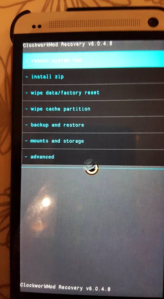

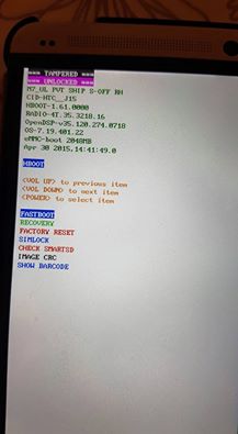

Dears,
I have same problem with my HTC One M8, I have android version 5.0.2
I rooted my device then got s-0ff by sunshine.
when I tried to install TWRP, the device always stuck in Enter recovery mode screen.
so I used clockworkmod recovery v6.0.4.8 and I successfully installed ViperOneM8_4.3.0.
My problem that the device stuck when rebooting, and I tried the instructions in the post by doing fastboot flash boot boot.img but it didn't work :-(
any advice?

Yeah - it's hard to read your screen well, but it looks like it says M7_UL at the top - you have an HTC One (M7), not an HTC One M8. In fact, from the rest of the listing, I'm sure that's true.
First, you need TWRP, not CWM, with Viper.
And you need the M7 version -
https://dl.twrp.me/m7/twrp-2.8.7.0-m7.img.html
Put that in your fastboot folder.
Open a command window there, enter FASTBOOT (tap power) from your HBOOT screen shown above, plug in to PC so it says FASTBOOT USB at the top and in the command window say -
fastboot flash recovery twrp-2.8.7.0-m7.img
Go into TWRP by going from FASTBOOT USB to HBOOT and then to RECOVERY.
Download ViperOne 9.0.0 -
http://venomroms.com/htc-one-m7/
TWRP, MOUNT, check to mount internal storage - it should now show up on your PC and you can copy the ViperOne rom there using Windows Explorer.
When done, uncheck the storage option in TWRP, MOUNT, back out, go to INSTALL, select the ViperOne zip file and install that.
Best luck!
