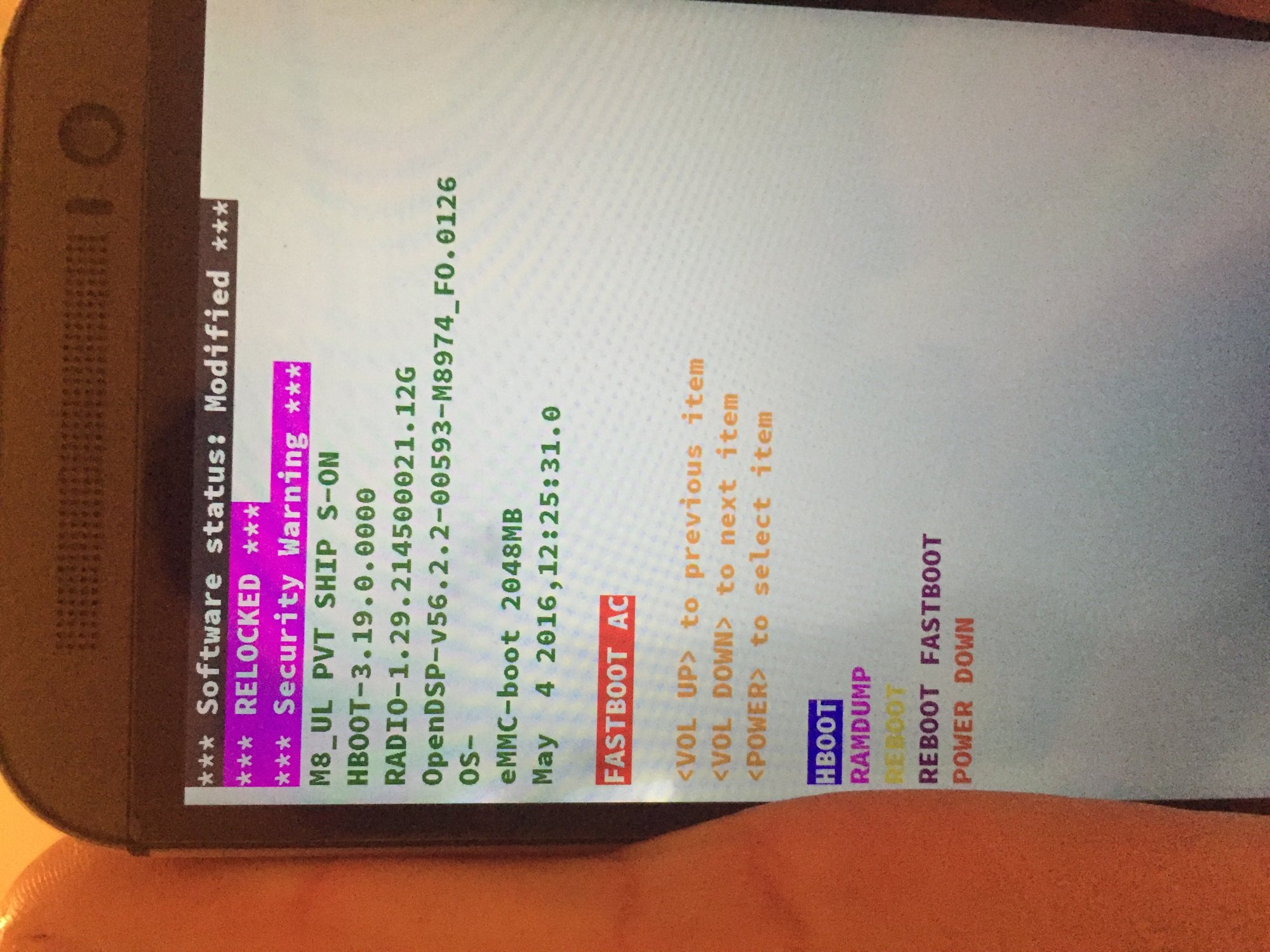

Thanks Marisa060. I tried that but no joy. It goes straight to the screen below
I'm thinking what you could also do is insert a Micro SD card into the slot because that also worked for me, too. I turned off the phone, inserted the card, and turned it on after the factory reset. If not, try holding down the power and volume down till it gets to that screen you just sent, select HBOOT, and then scroll down to reboot and try rebooting it
Thanks for you help on this. I tried what you said but no joy. Same result as before. Phone still wont get passed the HTC screen. Any other advice?
