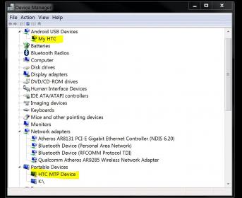

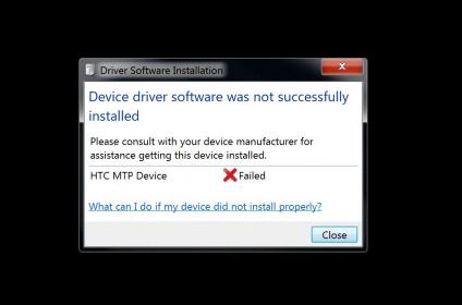

I cant run RUU cause there is no detection of my USB. The USB shows up for about 20 to 30 seconds.
yes.. and it will say waiting for device because the USB is not detecting, it only detects the portable drive when it mounted from TWRP.

I have tried all the different htc drivers I spent days trying to fix this. The phone is still frozen on the HTC screen with the warning its been over 10mins.

I tired what you suggested there, when you click on the link to HTC, it allows you only to install the HTC sync manager with the 4.0 drivers, they do not have the drivers separate.
