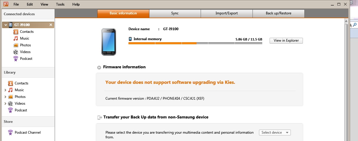

i read ur post....but not quite sure what to do.....any help
data from phone
PDA : I9100JPKJ2
PHONE : I9100XXKI4
CSC : I900OJPKJ1
kies data @ the attached image.........i'm pretty confused
data from phone
PDA : I9100JPKJ2
PHONE : I9100XXKI4
CSC : I900OJPKJ1
Hello and welcome to Android Forums Zeinynet! :)
There are a number of reasons that you will receive that message when connecting to Kies. See under, "ICS is available for my code but I cannot update", in post #1.
If you wish to update to ICS for the OJP firmware then you will need to flash it using Odin and the method described in post #1 under the heading, "My firmware is not eligible for ICS yet but I want it now!".
If you ere using the instructions and video in post #1 and downloaded your firmware from SamMobile, it comes as a 'zip file which needs to be extracted once. This will give you a .tar .zip flle which is placed in PDA. This one .tar .zip file contains all the files you need. I'm guessing that you have further extracted that .tar .zip file.
