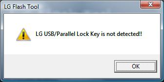

Hi, When I install the LG Flash Tool I get the attached. And then it asks me for a user name and password.
Thanks

Never seen that. Make sure the Flash Tools version you downloaded was 1.8.1.1023. There are older versions out there that will not behave in the same way you need.
Also, did you replace the megalock.dll as per the instructs? If not, that could be the reason. If you did already replace it, try the alternate megalock dll I posted instead and then try to re-run the tool.
Lastly, I can't remember all what drivers you have installed, but if you don't have the LG United Mobile driver installed, that could be an issue as well. Link for that here:
Directory Listing of //Xda/LG Software/Drivers/
I think it may be available on the LG website as well.
Make sure you are in download mode too and change the COM port as instructed. It needs to detect the phone in that state.
