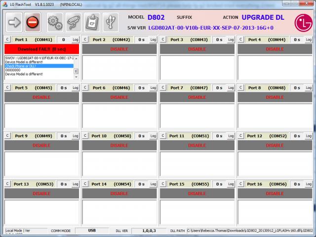

This is what I am getting now.
Thanks

Did u get any directions with the install of the flashtool or DLL . some DLL needs to be activated before you start .
If you got to that try and use the lg site to see if you can get the update recovery . cause it sounds like either the wrong model . cause the DLL should not need to update . now I can give you the instruction on how to use the tool but I need to know if your windows 7 or 8
I was working on it until 3 am with linux. Flashing data... Well in the end one of the guys who helped me asked me if im sure that it is the D802 and I was since I ordered that one. Well way wanted me to check the back of the phone and it turned out that is is the ls980. I got defraudet. I spent 10 hours fixing the wrong phone.

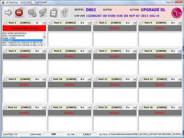

I am still having an issue. Looking at the error it says Model: VS980
Is this because I put on a Verison ROM by accident?
Thanks
So yeah its showing up a a vzw variant. Can we assume you still can't boot into recovery from a powered off state?
I'm trying to think of any drawbacks here...not sure if there are any...I think I might try to use the factory reset option. One of two things will happen. Either it'll bring you into TWRP recovery (if you didn't lose that from earlier actions), or it will indeed factory reset in which case that might be helpful in this situation.
