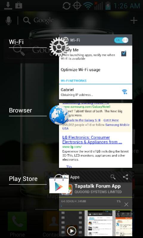

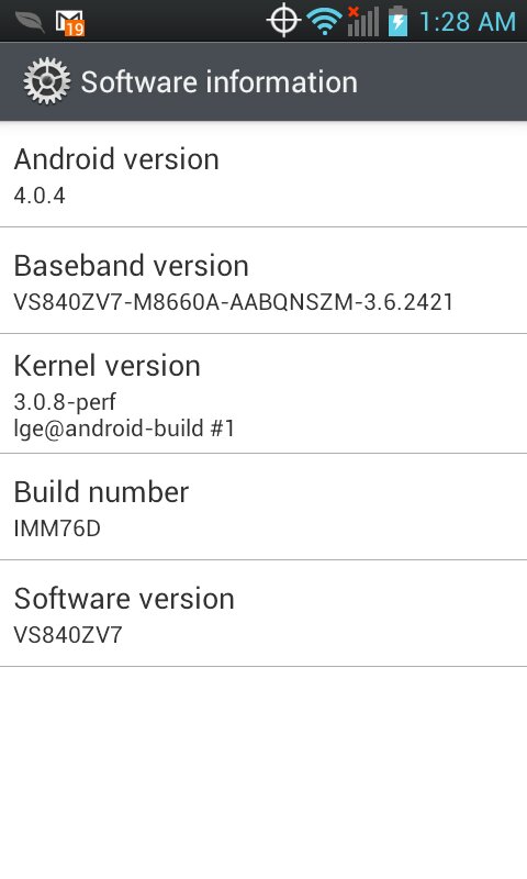

Here are some screen shots from the vs840 ics rom... I'm typing this using tapatalk over wifi. So far the Rom doesn't recognize the sim card im using so I'm getting no service.

1.YouTube is working
2. I'm able to play games like minecraft and temple run... I'll download NFS soon to see how that plays.
3. The audio sounds much better and louder then the previous zva rom.
4. As for bluetooth, I don't really use it so I don't have a device to test to see if it's working.
5. The GPS is able to find my location so thats working.
6. Voice recorder works using the phones mic
7. I'm able to take pictures with flash and record video with no problem.
The only thing wrong is that the phone heats up, I'm guessing it's because the phone keeps searching for a signal. I also notice some lag when I'm scrolling through pages and opening some apps. But, this Rom still feels alot smoother then zva.
