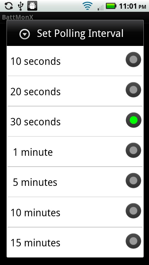

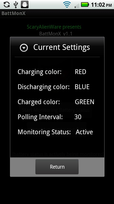

All,
Okay, I've just uploaded a new, 1.1 version of the BattMonX app to the Market. Behaves much better, faster, has more options, etc. I'm much happier with this one that the original 1.0 version.
V1.1 changes include:
- fix for orphan LED issue (i.e., LED still on when it should not be)
- main screen now displays if battery monitoring is currently active
- added menu option to change the polling interval to 10 secs, 20 secs, 30 secs, 1 min, 5 mins, 10 mins, or 15 mins; you can even change the polling interval in real-time
- added menu option to select/assign colors (red, green, blue, yellow, or off) to the various battery charging states (charging, discharging, charged/full); you can even change the color assignments in real-time
- added menu option to display currently enabled settings
- lock main screen to portrait mode to avoid issues with screen orientation changes
- save/retain settings/preferences across program launches
I have not had time to do the set-on-boot/run-on-boot option--that and a few other goodies are on the list of the next version ;).
Anyway, I don't remember if I indicated that the web page mentioned in the app is now up and active:
https://sites.google.com/site/scaryalienware/battmonx
My next task will be to create an app thread for this (let me know if you're tired of hearing from me in here and I'll just update the new thread).
Here's some screen shots:
BattMonXv11-a.jpg BattMonXv11-b.jpg BattMonXv11-c.jpg BattMonXv11-d.jpg BattMonXv11-e.jpg BattMonXv11-f.jpg
