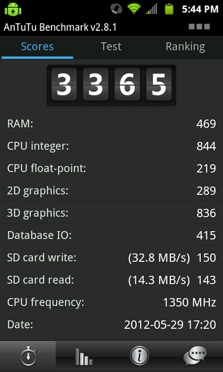

I agree with you ndno, my phone seems to run at 1350 with no problems than whenever I ru. A benchmark it freezes than crashes, I got my wifi working after a reflash, but the map in my phone is finicky, I was able to run your 1300 MHz kernel flawlessly, but this one just isn't stable yet. So weird that some phones run this no problems, and others are unstable

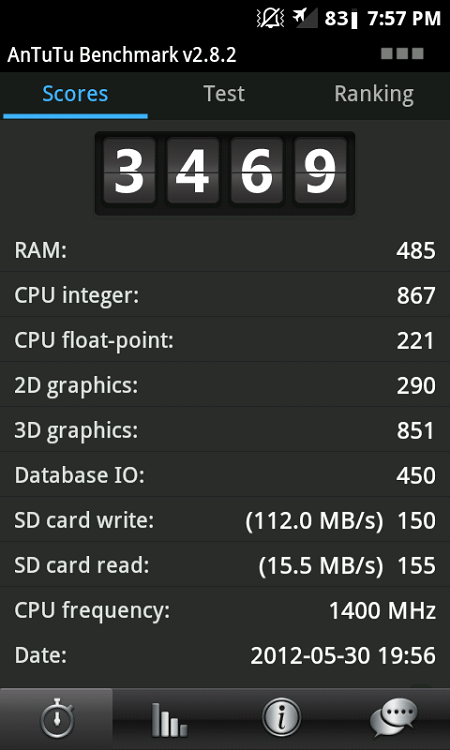

1400 (experimental)
1380 (experimental)

My phone can't handle 120, 1380 or 1400 and I have no idea if anyones can but I included them anyway just in case.
You guys got a shitload to choose from now so if you start lagging, your phone reboots, or your screen won't turn on after it goes to sleep your either clocked too high or too low, so find a frequency thats stable for you.
