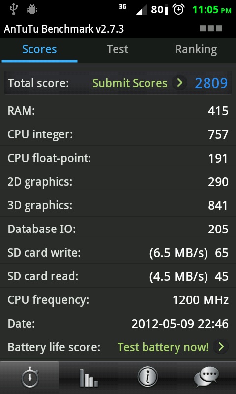

Right after the flash, I got 2809 unplugged. I can't ever get much above 2800. Probably because I've got the factory pos sdcard in there :o
My 3D score went up almost 100 points from previous tests on this kernel
1st is v3
2nd is v2
1st is v3
2nd is v2
How are you getting an 850 on 3D graphics? That's sick. What ROM are you running?
Running Blood's Sprint CTMod 3.6 and v3 kernel at the moment..
Just did 2 more benches, unplugged, got an 818 on the first and an 830 on the second. No idea. I was in the 750's in 3D before v3.
