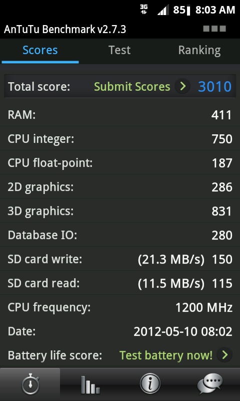

Great work imfm, I broke 3000 not plugged in using version 3 @ 1.2. :D
