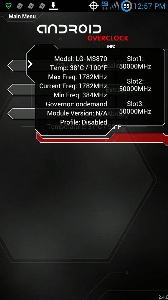

Went back to check oc settings and there back to 1.78 again. Very strange LoL
