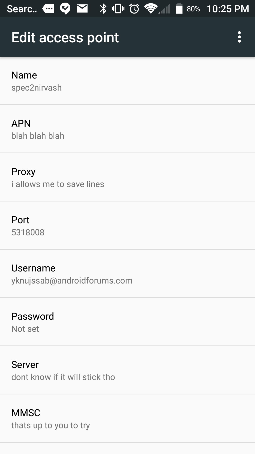

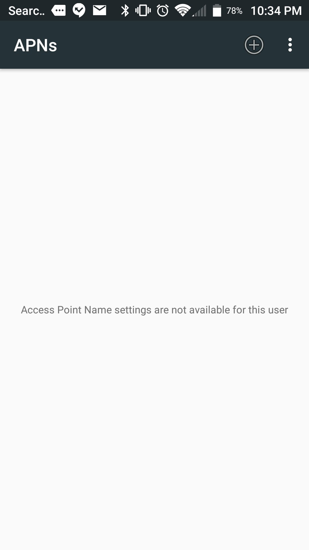

APN screen is different here, this wasn't accessed through settings. I tried saving the APN drafted above, but it didn't stay. Don't know if it's because it was a bunch of crap or if it wouldn't save a legit APN entry anyway....
