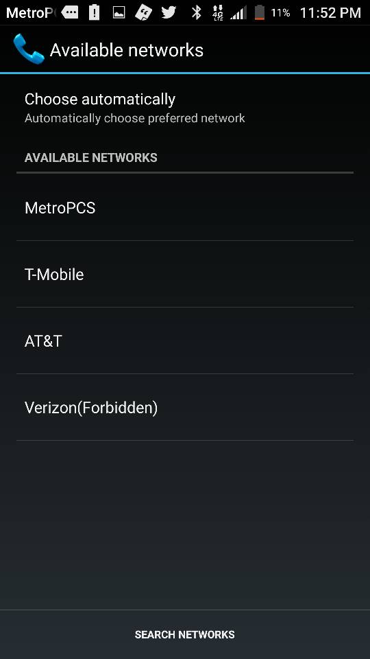

Also, found a hidden black/blue screen network selection menu. When I did a network search, it showed MetroPCS as well as T-Mobile? I switched between the two, both times it said 'registered on network'...
Both selections worked, both reset radio and showed 4GLTE, didn't seem like one was faster than the other, but uh, IIRC and obviously, aren't the two networks the same? I'm stumped with this one, but after tinkering with whatever i could gain access to and piss of the system, somehow kept my phone connected longer.
Here:

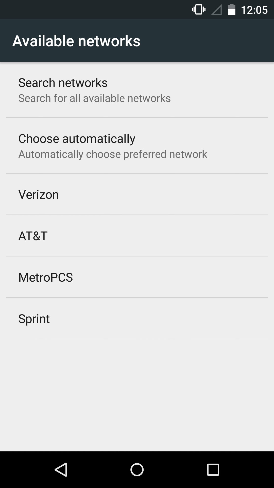

And a scan with my Nexus from same seat on my couch. Weird. Double secret network for ZMax users? I dunno. I'm not a cell network expert :)

Those using the MetroPCS network are supposed to get de-prioritized below those on the TMO network when in areas of congestion. So, switching to the TMO network might give you a better experience in congested areas. Good find :)
