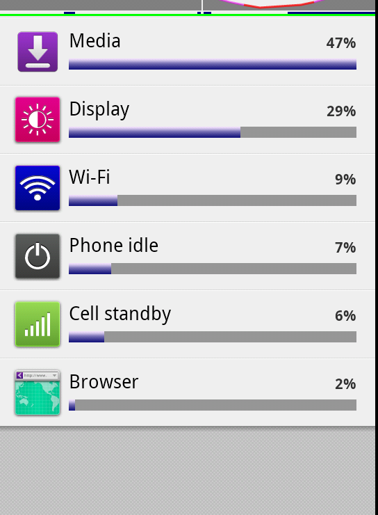

i checked, settings/battery & data manager/usage statistics and have attached screenshots of the results

Obviously your biggest clue there is the "media" using 47%. Figure out which app is causing that. Also looking at your screen shots, I have never had my entire notification bar at the top of the screen filled up with icons for a dozen different things that are running. You obviously have a ton of stuff running so naturally your battery is going to take a beating. Speaking of that, just because your battery suddenly starts dying doesn't mean it's something software related, it could be the battery itself going bad.
I keep such a bare minimum on my phone that it's never an issue to just factory reset it and start over. If you don't feel like doing that, you have to find a way to shut down the apps and then reintroduce them one by one and see which one starts causing issues.

something had changed the brightness of the display to high, so i have turned that down and the battery isn't draining as fast and is not as hot as it was previously but is still warmer than normal.

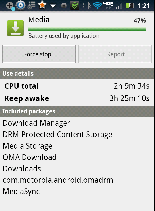

I have just checked the battery usage and the "media" is using 64% of the battery....far more than anything else.
see the screenshot,
not sure what I'm looking at in that screenshot and how to fix it
any suggestions?

Media. As in something Media related. As in:
Play Music or MOG music or DLNA or MotoCast.....
Something is constantly connecting to a media server you're (assuming) recently set up, or recently changed, or recently uninstalled (but forgot to remove from your phone). I suspect it is the last one, b/c then it is very similar to the other user who posted about their ISP changing mail servers and their battery going stupid b/c mail was never sending but constantly trying to....
What I'm saying is forget about all these other things and concentrate first on trying to figure out what the heck that Media thing is on your phone.

Quoted to say that I agree. It's likely not a bad battery - the MediaServer is a huge clue that the phone is playing/trying to play some sort of media. Not that I am suggesting this, but I suspect that if you factory reset and reinstalled everything from scratch, you'd find the problem solved.
I think that Badass Battery Monitor is a good step. Thankfully, I have never had an unexplained battery drain myself, so I wish I could give a more concrete suggestion, but if you can figure out which app or process is trying to play some sort of media, that's likely the solution.

I've searched google and found another possible answer where the problem was something on the sd card that was keeping process.android.media running. They reformatted the card after backing it up and it solved the problem.
I do add/change/delete alot of audio and video form my sd card to watch /listen to on my players
I'll check into this as well
I think (knock on wood) that i have found the answer and solved the problem.
In my post yesterday, I said i had located another thread with a similar problem and that seems to be what was wrong with my phone.
I had a large video on my laptop that i reformatted/rendered in handbrake for my phone using the "Android Mid" settings in HB.
The video was too large and i wanted to make the file size smaller, i also cut the frame rate down to something like 12fps.
i stored that video on my sd card where i have stored other videos lots of times....videos that i also rendered in HB using the same method as this video.
I removed this video from my phone and the problem has stopped for several hours now (crossing fingers)
temperature is down to normal
"Media" is no longer shwoing as the biggest user of juice in GSam Battery Monitor
battery is holding charge and back to normal, not draining
