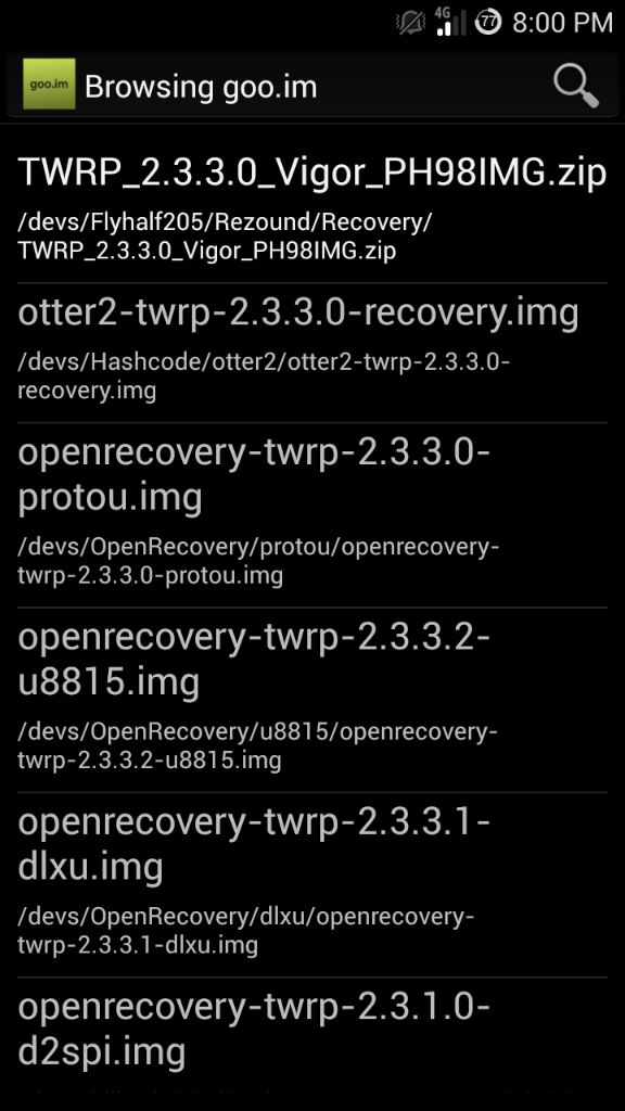

I have no idea if I have the lasted TWRP installed. How would I check that? And update date it if needed?
Edit: I just checked and I'm running TWRP v2.3.1.1
Which of this two versions?
I'm not sure if all 2.3.3.0's are created equaled. Those aren't for metro so I would just avoid them. Install from goomanager is the safest bet. There's no choice it picks and flash for you.
What do I press in goomanager to update? I can't find it
I pulled that from goo I just type twrp and get those two options
