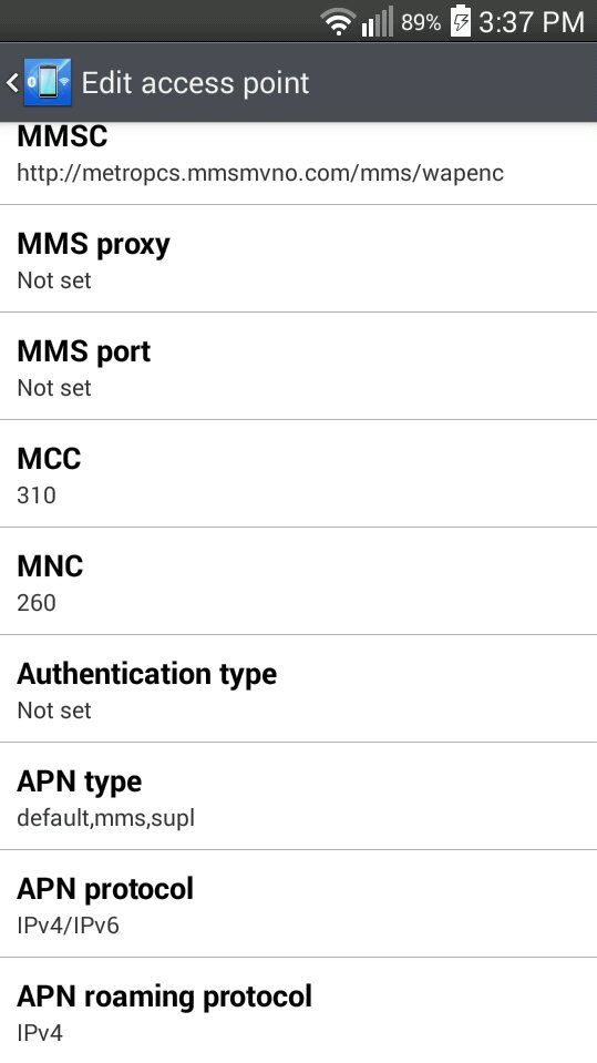

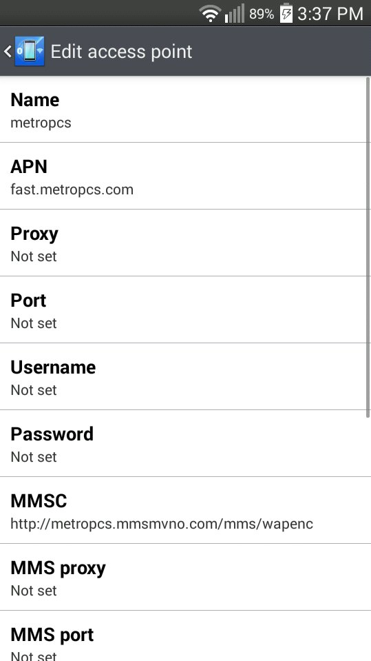

I am having only one issue with this ROM. 😃. I am able to text without issue, but it won't send if there is an attachment. It has this message. "Currently unable to send your message. It will be sent when the service becomes available." What could be the solution? Any help would be helpful.
Messages with attachments get sent as MMS messages.
Make sure you have your data enabled when sending, and that you have an available data plan for your provider.
Is there a setting somewhere to set this up? I have data running and my plan is unlimited. My wife has same phone, hers has stock ROM. And works perfectly. So it seems to be a setting in this ROM.
Check your build.prop for anything that has EUR, and replace it with US
It was a solution earlier to the 4G data issue, so it may work for your issue.
Check if you can connect to a website using your data plan from your phone.
Go a few pages back and look for a guy that posted his whole build.prop, copy and paste it on yours, reboot and then that'll fix your qremote and late problem, if I can I'll quote it
Took some time and a bit of research on the internet. But, I got my phone to send pictures from my gallery in texting. 😃. Here are the settings. Hope it helps others.
