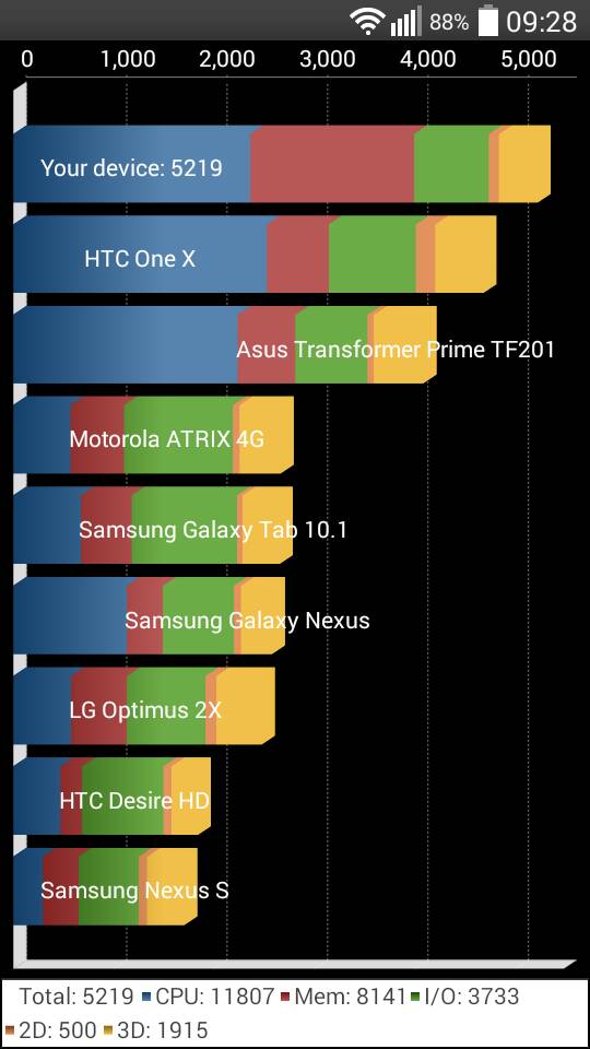

Not sure if this is a bug or if you left these features out. When you goto app drawer and touch the menu button (button left from the home button) it does not bring up the normal menu you would see from jb ROMs also the same applies when you goto gallery there is no settings menu when clicking on soft menu button. Other then that so far its a smooth ROM I will be testing all day to see how it does thanks chefs. :-)
@ desolation jones.
Not to shabby , lol and gets better over time.
Thank you all .
Flashed it last night ... feels similar to the L70 really smooth. Unfortunately for me my back cam still doesn't work and usb tether doesnt work either... really bumed out about the cam i wanted to keep this rom but i need my cam so back to Xperion. Thanks

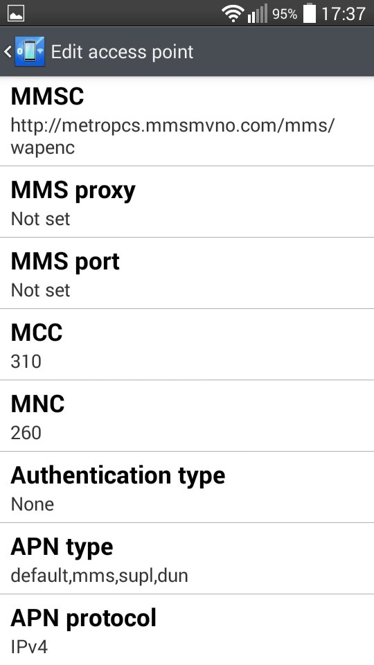

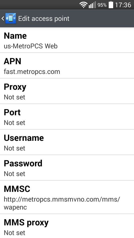

Did you add the apn
If you switch out the apns-conf.xml file in system/ect with one from a jb stock ROM before you zip the ROM then there is no need to add the apns manually
That is only true if your phone is not unlocked and service is locked to a carrier. The cost of this device will and is a great value for pay as you go carriers. Which requires an unlocked device.
Once you have phone service , setting up an APN is basic. This let's anyone use our killer phone. And it increases the useful life of the f6.
You could just share it with a link to it here. Please list the carriers it supports when and if you do.
Try these APN settings for metro . Don't use (,dun )the first time its for tethering, if you've been reading along.
if n/w reinstall as stated in the first 2 posts of this thread. Remember let it set 10 mins. Then do the set it up.
If that don't do it send me a p/m and I'll send you a nandriod link of my own phone. Short of that Go hit up game theroies experion. Thats the only ROM your posts do show you have not tried and had a problem on. And it is a custom ROM. Just find something that works for you. I'll help.
