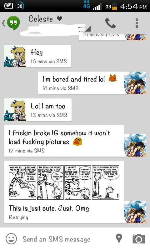

:p Also, does MMS work on the Hangouts app for you? On Cricket it'll just say, "Failed to send message." Or "Retrying..."

Well I'm still annoyed that Hangouts MMS isn't working. I guess i'll just have to ignore it for now and use kik to send pictures. :rolleyes:
i doubt MMS will ever work on this device with hangouts. Unless of course it reads from APNS, if that's the case then a simple apns-conf.xml edit with boosts MMS info should fix it. But i doubt its that simple lol it never is.
Remember, this is a Cricket Wireless device. :p
well then the cricket info lol, the Nexus 5 is a GSM device so odds are hangouts reads from apns-conf.xml. Google a cricket apn and add it in system/etc, be sure to backup your old apns-conf.xml before hand just in case it doesn't work. then reboot
