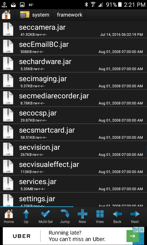

what root browser you using? i'm just placing the 2 apk's into that folder, changing the permissions on them. then i place the .jar in the other appointed folder and changing the permissions on it. then rebooting to see no changes.
EDIT: i haven't done a lot of tampering with system files so it's definitely possible i'm missing a step
Ok lets get this working, The 2 apks go into System\app. Not Data\app. The jar goes into the system\framework. Ko
i did everything in root browser. Everything set to 644 permissions
Worked! thank you so much for taking your time with me.
