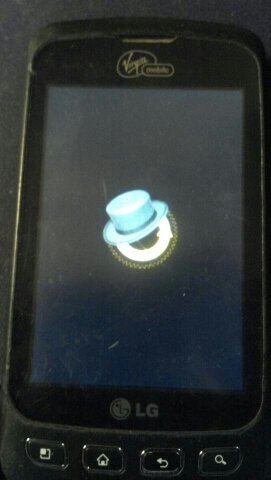

This is the message I get when my phone reboots into recovery. What does this mean?
I think you need to fix your screen shot. Make sure the Img tags are correct. The first one should be [ and ] with IMG or img in-between. Then the image URL. Followed by the [ and ] with /IMG or /img in-between .

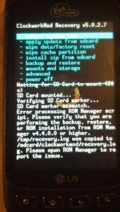

Ok, I think I have it now. This is what my recovery screen looks like when trying to install a different ROM. And to recap what my buttons do, Power, back, and search all transition between these two screens, Vol. up, Menu and Home does nothing, Camera takes the highlighted block back to top, the button beside the camera button scrolls down, and the Vol dn. scrolls up.

Did you use rom manager to install the recovery?
Try to flash this: Cannibal Open Touch v1.2 ZIP Download
Original post: [RECOVERY] Cannibal Open Touch v1.2 (latest update: 06/24/2012)
