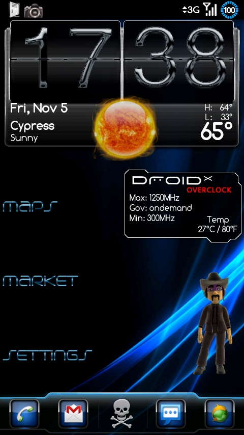

My screens are a little all over the place, trying to come up with something but got the color changed on the battery. Woot!
Thanks mxsjw for letting me bug ya :)
Home and lock screen, I know a lot of people don't like the blues but I keep going back to black and blue :)
