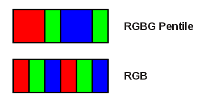

Instead of small vs. big, the math is simple - PenTile subpixels are 50% larger than rbg subpixels.
1 pixel = 3rgb = 2 pentile, so pentile = 1.5 rgb - all other math flows from there, but there's the degenerate case to clarify:
On a hypothetical 3"x4" screen, using the same chemical formulations for SAMOLED/+ pixels, displaying an all-red field, the rgb screen will light up:
1/3 x 3 x 4 = 4 square inches of the screen
Whereas the Pentile will light up:
1/4 x 3 x 4 = 3 square inches of the screen
To produce the same effect, the PenTile will have dynamically increase brightness (and consume more power) - and by design, it does.
Those calculations may apply for RGBW (I haven't had a chance to think about it), but they definitely don't for RGBG. The surface area of RGBG will be exactly the same as for plain RGB for any color background (ignoring black voids between subpixels, which is beyond me), so one can guess the brightness and power draw will also be about the same.
See the .png I made for this -- different numbers of subpixels, but the same cumulative areas for each of R/G/B across pairs of pixels.
I see the png, but not sure if that is AMOLED or SAMOLED.
In any case the PenTile creator confirmed that all PenTile displays use dynamic brightness processing, as I recall.
EDIT - I haven't found a source to refute your call-out on the pixel sizes.
Both images in your png have large masks.

Now that we have our own thread, I can happily square that point away.
Assume that an rgb subpixel represents a unit area.
Red would be produced by 921600 unit areas for rbg.
Red would be produced by 460800 x 1.5 = 691200 unit areas for pentile.
691200/921600 = 3/4, same ratio for the shortcut math I started with, comparing ratios of 1/3 and 1/4.
There is an error term due to mask width, but it's minor.
And if you look at fields of color and work down, you'll find it always comes out this way, regardless of pixel sizes.
If my hypothetical 3x4 pentile screen had only two rgbw pixels, a full field display of red would still be 3 square inches.
Hope that clarifies why PenTile needs that processing, has that processing, and while honestly claiming many benefits - does not save power or use more, integrating over a full range of use cases.
It just is what it is.
