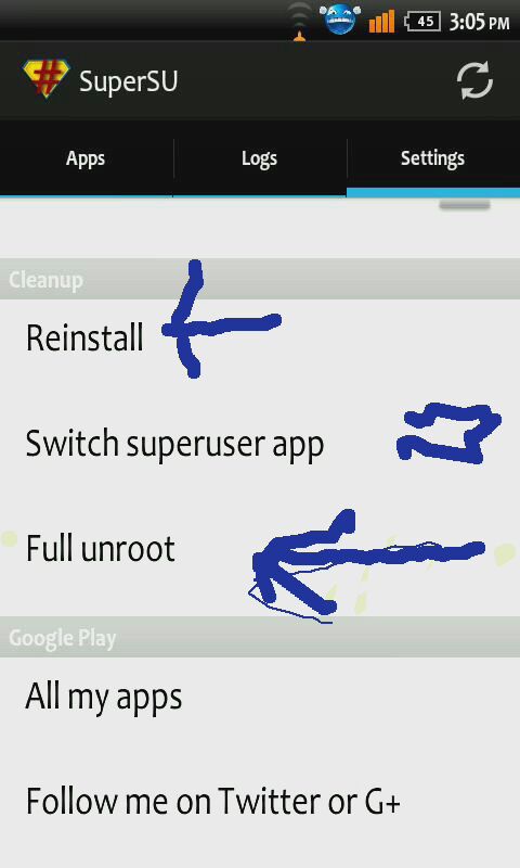

See if you use the super su apk . Its the same and same builder just better has more things to control . But every time i tried to do it that way had to reflash cause the dam phone just forceclose and wont allow you to do nothing .

Have you tried using a root browser to swap out the apps in system/ app?
Or using titanium backup to make your preferred su app a system app and freezing or deleting the installed one?

Since the su binaries are app specific if one wanted to they could push the preferred app to the system make sure it's updated as a safety precaution then uninstall the other with TB...

No. That's why I ask before leaping. I believe in don't monkey with the monkeys monkey. But since its unanimous to use only one SU I will try to freeze the Chinese SU and update my SU's binary. Do I understand this right?
Isn't that pretty much what I said? I just said it as simple as I could.
Yeah. If that works You can also backup (just in case) And uninstall the Chinese one
I froze the Chinese SU and tried updating the binary and it all passed until it got to the line Remounting /system as ro... failed. I'm using the ChainsDD Superuser app. What am I doing wrong?
