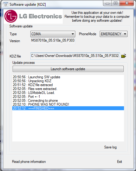

I tried sammyz unbrick method.
It ends up like this... :confused:
attachment.php
I will be testing sammyz unbrick guide, when i get home from work. I dont know how i screwed this phone up so bad. Lol.

Thank you so much guys. I got the phone back on stock! Thanks sammyz & everyone else! :)
