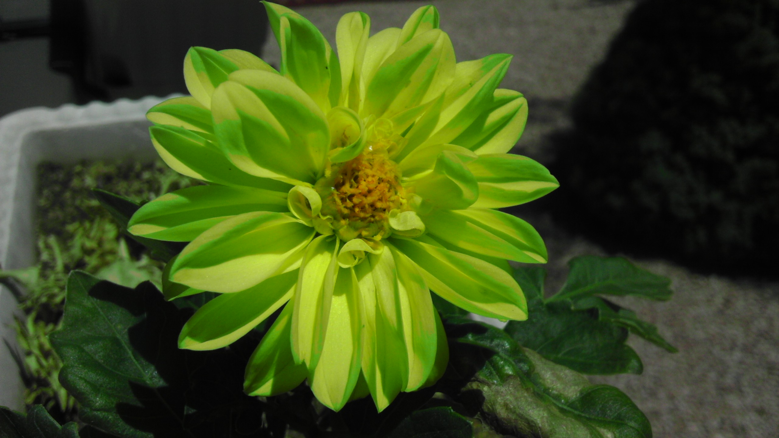

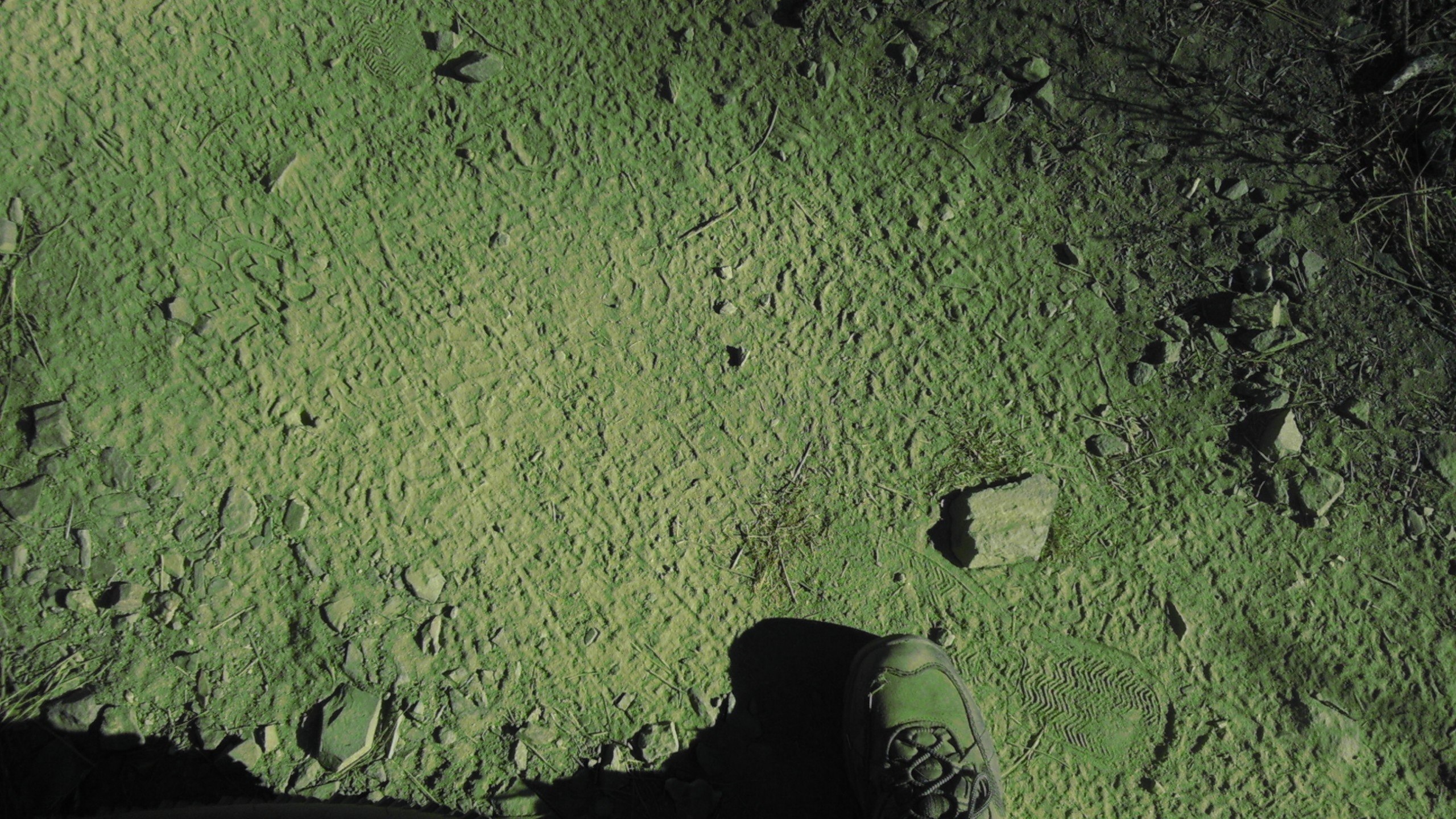

I have no problem with the resolution of the camera, I think it does very well. It's just the green problem that makes me crazy. Indoors and shaded pictures are outstanding. Oh, and did I mention the macro capabilities are amazing. I will include some examples here. The flower is yellow. The other shots are dirt, not grass, this is Arizona...
Wow.... that is really green. Definitely a defect.
