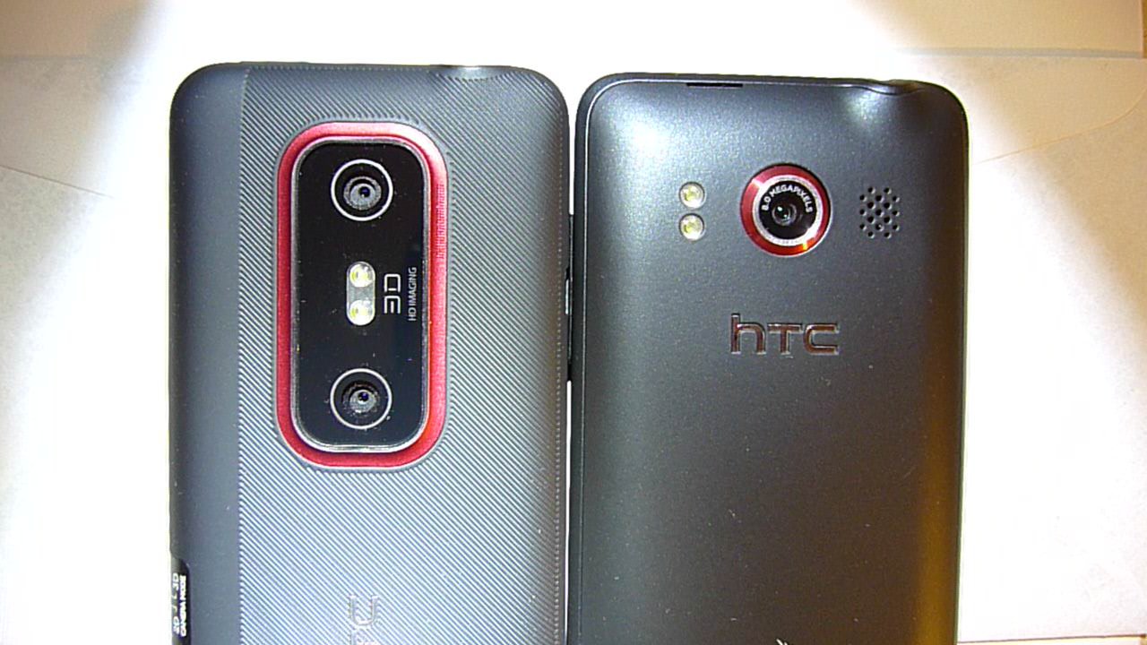

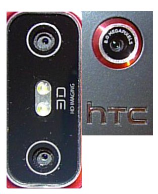

I've been desperately trying to figure out the sensors used in the Evo 3D to no avail (via the dmesg command in the android terminal emulator app). No such luck yet.
I was looking at the Evo 4G and Evo 3D and noticed that the lens/aperture for the 4G actually looks to be bigger than the 3D. In theory a larger lens/aperture will allow more light to come in...

As for the apertures between E4G and E3D, I noticed that as well. Still, it's hard to say what the ACTUAL aperture is. That's determined by the fan blades that can create various aperture sizes and resides behind the lens. Not sure if the EXIF info tells us aperture. I don't think it does.
Maybe the pixel density on the sensors are the same between the cameras, so they don't need the same size aperture. That would imply that the resolving power of both phones are comparable, with Evo 3D having better focus but performing slightly worse under low light. This is consistent with the findings in my OPs.
Unfortunately, the EXIF only includes focal length and ISO information.
I don't think (though it's merely an uneducated guess) there are aperture blades on cameras like these -- it seems to me that it's a single fixed aperture; basically that there is the sensor with a small lens above it, and that's it.
On this note, with a fixed aperture value, you can theoretically mimic shutter priority by adjusting the eV/exposure value on the phone -- decreasing it if you wanted a faster shutter speed. The obvious result is that you'll get a darker image, which is exactly what you would expect if you wanted less motion blur in a situation with less light (holding the aperture and ISO constant).
You might be right about the decreasing sensor size though... Assuming an 8MP sensor on the Evo 4G with a 1.4
