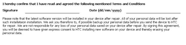

CPW were very helpful and connected the phone to a special service box to access the phone to retrieve the data but unfortunately it didn't work, but worth a try.
Having spoken to a manager @HTC they again were very helpful and understanding and agreed not to try and wipe my phone during repair...though no guarantees :eek:
It seems they use a 3rd party company as their service centre so they might just ignore the instructions, will just have to try the above and see whether it works.
Thank you both again for all the prompt help and advice, they're picking up the phone monday afternoon so i have until then to tinker..

Hope you manage to get the data you need off at the weekend. When you send it off, you could attach a note yourself advising what the manager told you about not wiping?

Yes already written the advice note thanks with a huge circle around the disclaimer left unsigned...
attachment.php
hope their repair better than their spelling!!
