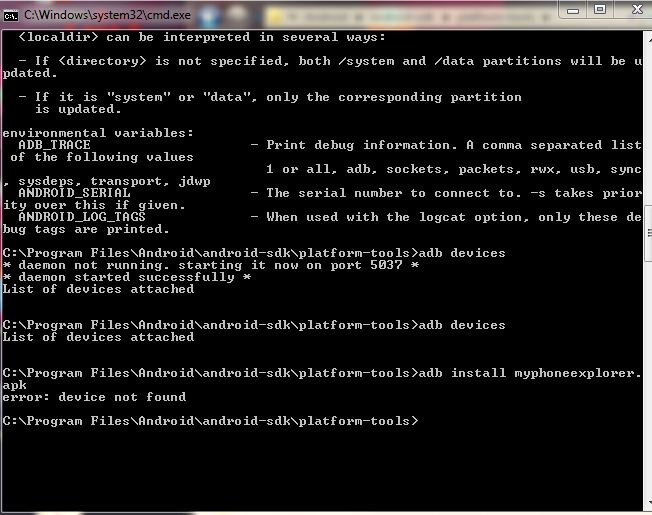

If it's not finding the handset after a fresh install of HTC Sync, I suspect USB Debugging isn't enabled so it's not going to work unfortunately.
