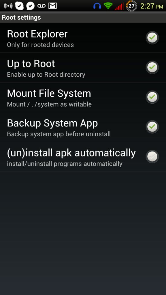

Do me a favor, install Estrongs File Explorer, settings to home directory as / and root options like this, and tell me if you can see into the /system folder.
The Root Settings folder, as you've shown, is darkened except for the first 2 options. When I try and check the first one, I get an error about SuperSU and then it blacks it out.
