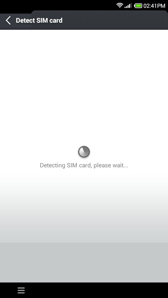

Root PORT: Miui V5
Just sticks there... Can't even skip :(
For now,copy provision apk from cm11 app folder to app folder of this rom. Then reinstall the rom. Not complete fix but you won't encounter the provision of sim at all.

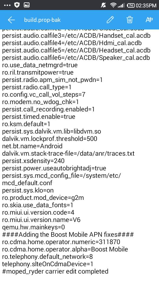

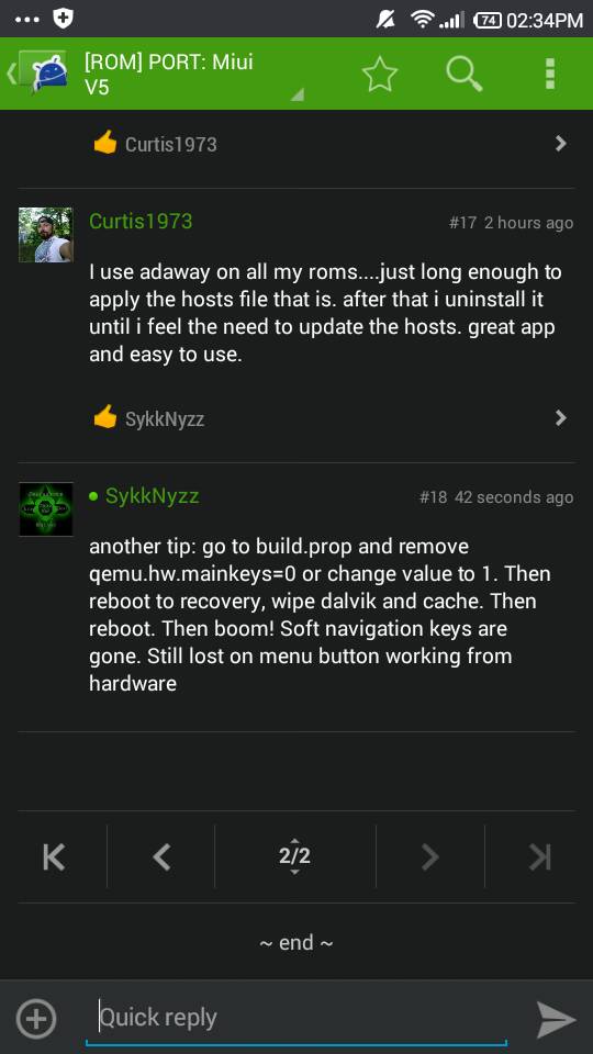

another tip: go to build.prop and remove qemu.hw.mainkeys=0 or change value to 1. Then reboot to recovery, wipe dalvik and cache. Then reboot. Then boom! Soft navigation keys are gone. Still lost on menu button working from hardware
Might be late in to the upcoming week but I can see whats up with the key mapping and remove the onscreen navbar.
