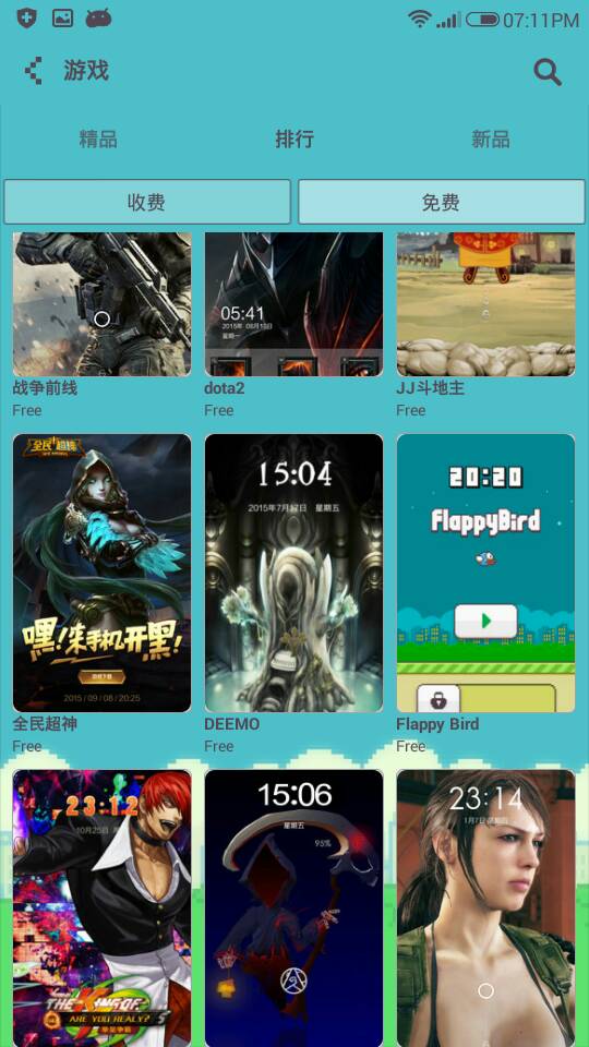

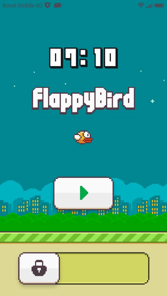

On a positive note, I love this theme manager. Found this one on there. Let's you play flappy bird from the lockscreen
