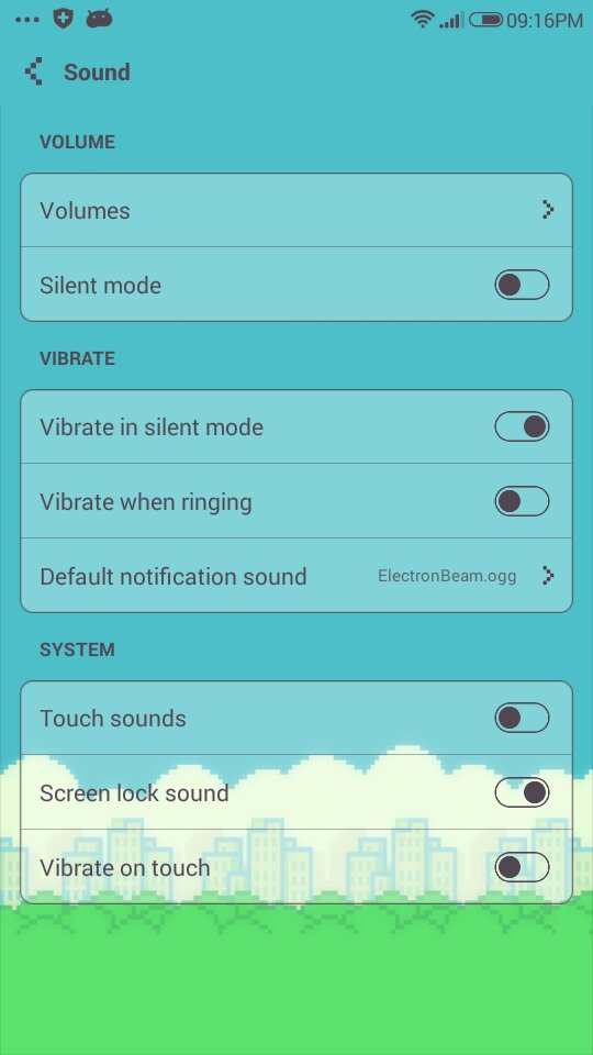

*facepalm* no settings for this anyway
Dang it :(

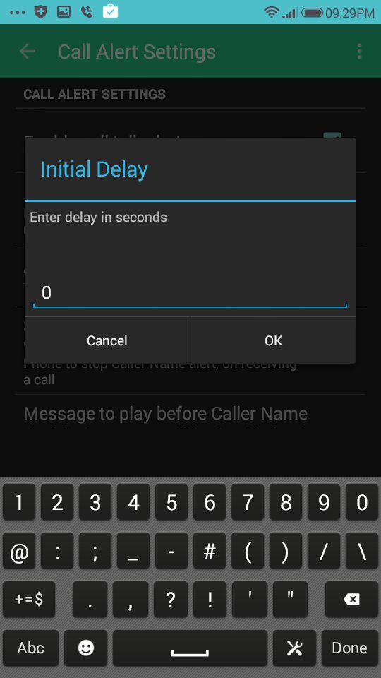

Here is a temp solution
https://play.google.com/store/apps/details?id=com.pa.caller
It will announce the caller by via media volume instead of by ringtone. Just set the repeat interval under caller to 2 or 3 seconds and initial delay to 0.

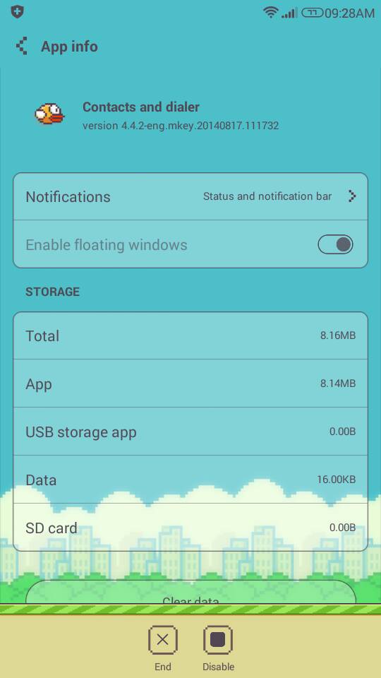

Screen shots
