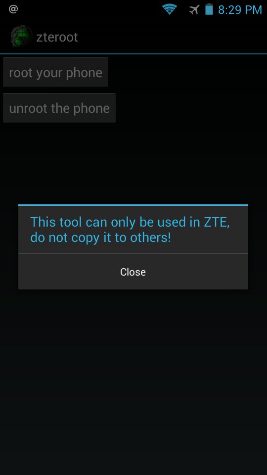

In the zip theres a zteroot.apk? how exactly does that work? i installed and i tapped root but it said mismatch version assuming that it knows that im on b11 rather than b09.
Yup
Take a look at this logcat. I'm I reading this right? Is it calling for version b15 or b21?
Changed my sw version in build.prop to the one its asking for and boom
