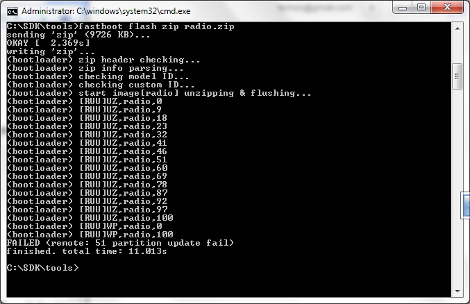

I've tried it many different ways with RUUs, fastboot and PH36IMG, but RADIO_V2 repeatedly fails to flash.
I can also flash any recovery, but it fails to load, getting stuck at the Evo splashscreen, so that is also a problem. Most partitions flash nicely in fastboot. A successful system flash will result in a stuck Evo splashscreen, though.

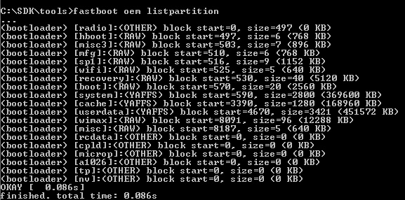

4. Typo. Flashing any radio in hboot will result in [see attachment]. Flashing in fastboot- see 2nd screenshot above. Fails either way, and I've tried multiple radios. Tried under multiple hboots, too. No dice.

The only idea I can come up with is using an elevated command in fastboot oem which could reformat my radio partition somehow. I don't know whether I have ADB either. I do have a Linux box, so diag mode can be done. Have some experience with JET on the HOX.
Any ideas?

Of course. That was the only option I had anyway since there was no accessible hboot to fall back upon. 4.54, 4.67, 4.53. Radio_v2 fails every time.
So apparently this is one of the radios used in China for using the EVO 4G with CDMA UIM cards. They then proceed to hardware mod the phones with UIM slots- I have one of those slots.
I don't know whether that should cause a radio to not flash on a NAND level at all. It shouldn't really.
