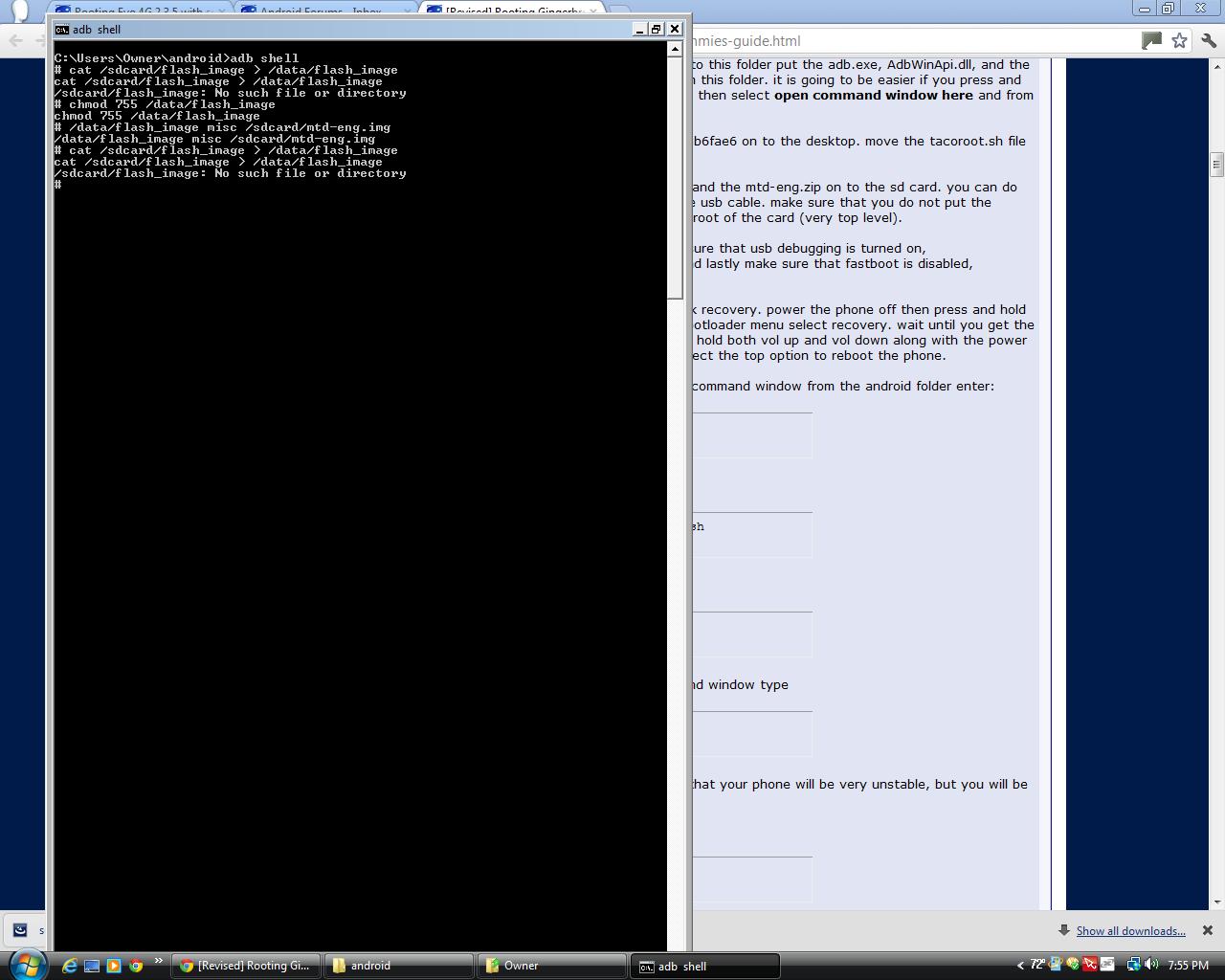

Ok, well now I proceeded to the next step(11) and it gave me the "#" so that went right. But then in step 12 I typed the first command and it said "No such file or directory." the other two following that appeared to work though. Is that normal?
I placed a screen shot of the adb shell as an attachment
When I did the three comands in 12 there was no responce in the adb box untill i did step 13.
Your phone needs to be connected to the computer in Charge only mode. If it's still set to Disk Drive mode from when you copied the files over to it, the adb commands will not be able to read from the SD card, and will give you that error. Since the device is now unstable, you're going to need to issue the Tacoroot undo command, and start over with the first Tacoroot command (after you change the USB Connection to "Charge only," of course)

thanks, i am starting over for the fourth time, can you tell me what to do if on step 12, when i enter cat /sdcard/flash_image > /data/flash_image it says no file or directory found. I unzipped the file and added it to the sd card, i went on to enter the next two commands and they worked fine. any advice on this would be greatly appreciated.
As long as in step 11 when u type adb shell the prompt chenges to # and the file is on the sd card in no folder and the comand is typed corectly u should not get that error. I did not get that error so i dont have an answer for that. if it happens i would ask here again and someone should be able to help you.
You usually only get that error when the device is connected in Disk Drive mode instead of Charge only mode.
Either that, or the file hasn't been extracted to the root of the SD card.
