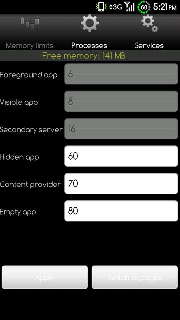

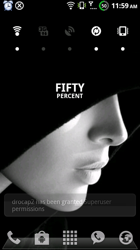

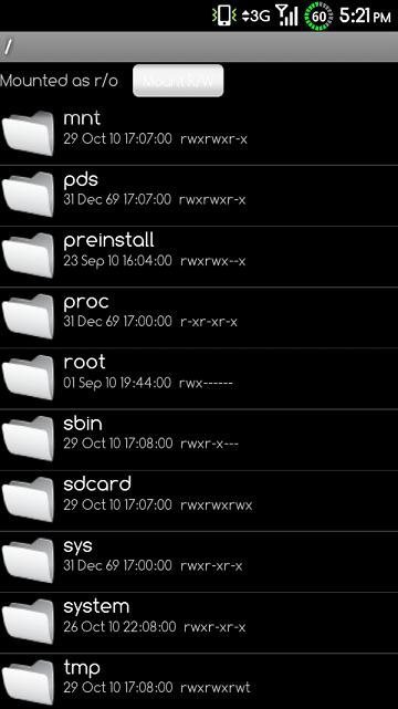

Installed via rom manager. Button fonts are now white (on light gray buttons), and a little hard to see. Screen caps:
