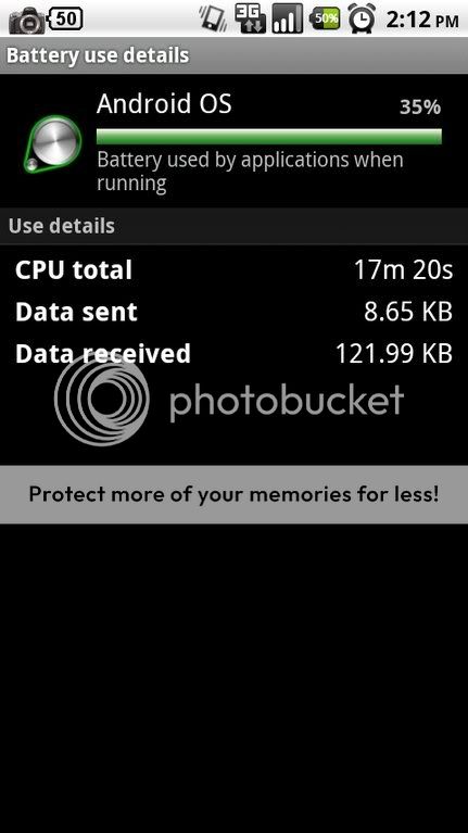

curious indeed, as I've never seen Android OS that high before. Do you see any suspicious processes when you click on Android OS (it lists all the processes it encompasses)
Not other than this, unless I'm looking on the wrong place
its just weird
doh! that's my fault, I confused it with 'Android System'
Spare Parts is a good idea, take a look in there. SystemPanel will also do the same thing, though with a nicer GUI.
I don't see anything unusual in System Panel , could be I don't know , either how to use it or what to look for, but if I'm reading this well, there is nothing unusual here:confused:
Could be the overclock profile Im running, -ulv ?
Just did a Reboot and it went down to 16%
